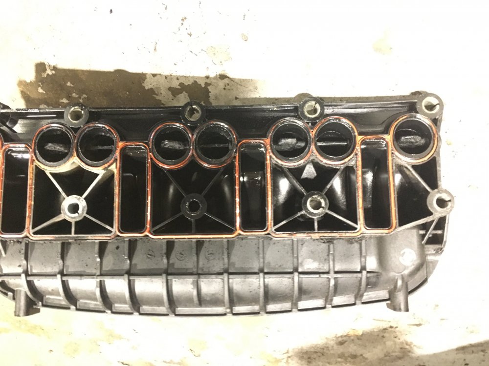

Advice to you all....Thanks Phil for your update on the BKD. I'm happy now with no more flaps, car feels massively different, aka as it should be. No more juddering and missing boost....
If you see this....
Then replace the manifold asap. I was quite lucky in the grand scheme of things.
Next thing to greet you, the intake side of the intake manifold. EGR is equally messed
All flaps destroyed, most missing entirely.
Oof yours was worse than mine, my flaps were all still intact. Glad it worked out well for you :)
