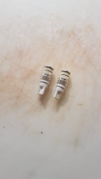

Finally sorted in case anyone reads this. Tried a third set of bulbs from another member which worked in their car and hey presto no error code.
I don't have a link to them but they looked like this:
