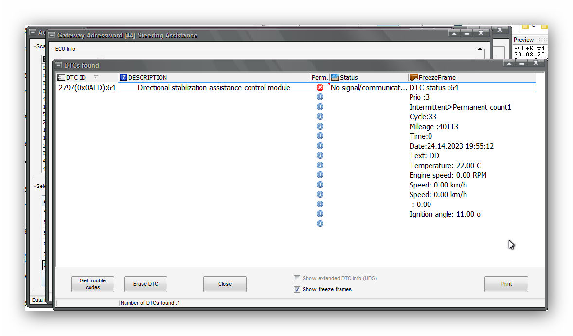

What is causing this error message?
I have a 2014 S II estate DSG 4x4 L&K.
I have a "Directional stabilization assistance control module" error in module 44 on a scan. This is a new error. I have not coded anything new, but have tried some adaptations in #44, but have also recorded every single change and reversed all the changes. I do not think I have this "Directional stabilization assistance control module" in my car. As far as I can tell this has to do with Lane Assist and this is not built into S IIs. It does not appear in the Gateway.
I have a problem with the PLA in that it switches off after I do get the correct picture displayed in the Maxidot. I can choose parallel or 90° slots and the system tells me to go into reverse but then switches off and displays that it is finished.
I assumed the problem could be with #44 but I am not sure.
I have attached a autoscan, a PDF file of the error and a screen shot.
autoscan_20160317_1533.txtdtc 44.pdfpost-133229-0-59370400-1458387816_thumb.jpg
Edited by 26DIPP

Could well be an adaptation issue, the error code is not really helpful is it!
I found some information on a Golf V steering assist. By the looks of it I introduced an adaptation change in channel 6 - telling the car I had a lane assist - although I did not have reason to look in ch 6 as VCP does not offer any clear text info for this channel.
Now no more DTCs!
PLA problem solved. It is fully working for the first time since I have the car.
Sadly our dealer was no help at all.
A tick was missing in module 03, byte 17, bit 0. I do not know what it does but it seems to be crucial.
It was quite scary at first to have the car swing round the steering wheel and speed backwards.....
