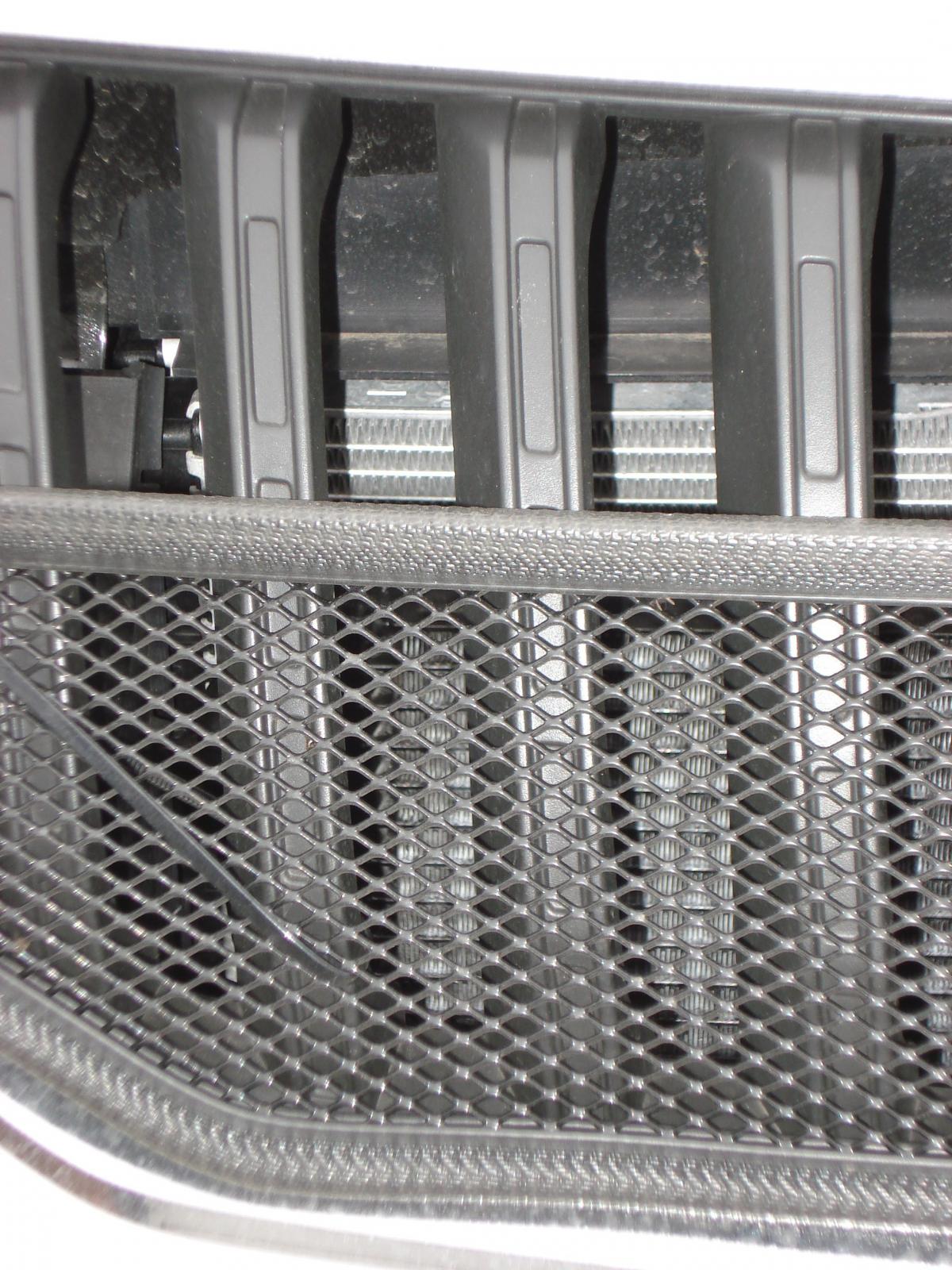

I have made a couple of mesh stone guard "things" but

I adapted one I made for the pre-facelift Yeti I had and made one from
the scrap of mesh left over.

This is my mesh halfway up the top grill
Ah, looks like the F/L model cond/rads are a lot lower.
