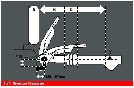

Hi,  Tow bar looks great.  The video shows it off really well.  Currently waiting on a confirmed build date for my SE-L (sitting at unconfirmed build week 14) which has the factory fitted tow bar.  Will be using the car to tow a caravan with alko stabiliser on it which needs certain clearances on it (see attached drawing).  Just starting to worry that the tow bar wont meet the required clearances,  Has anyone who has the fitted tow bar towed with a alko stabiliser or could someone measure from center of tow ball to bumper?  Thanks. D.post-135637-0-65013800-1458724589_thumb.jpg

There's a lip around 1 inch above the towball too which comes out of the bumper for approx 5mm which is hard to capture in the photo.
The clearance of 60mm from the bumper to the towball outer edge is going to be very tight as the bumper lips out above towball peak height.
Though I would expect it meets the requirements surely

What a brilliant response.  Cheers RickTT.  Looks as though it should be grand.  Just had that fear that it wouldn't work, now I just have to wait for it to arrive.  Been waiting nearly 2 months now, hopefully not too long to go now.  This forum has been great to read however it makes the waiting harder seeing everyone get theirs!
My 2014 caravan has an Alko stabiliser and clearance is fine.  Just be careful if the hitch damper gets compressed when you come to unhitch as it will definitely hit the bumper as soon as it comes off the towball if you don't back the caravan up a little.

Good to hear the clearance is fine.  It was just a few of the photos of the tow bar made it look closer than it actually is to the bumper so got me worried. Always a good tip to ensure the damper isn't compressed before unhitching.  What was the car like to tow the caravan?  Which engine do you have?
