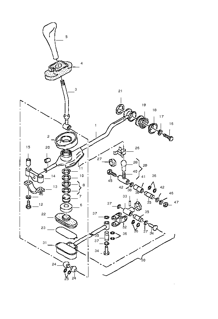

i have this type of linkage. i think the play is at part 24, 40 and 16,17,18,19,21.
Same linkage as mine. Item number 30 on that diagram is what I bought (it's the main moving part of the entire linkage) and fitting that solved a lot of my gearchange issues and tightened up the lever quite considerably. The top "bar" is more a support bar so doesn't actually wear a huge amount. With the multiplication aspect of the actual gear change rod, a small amount of free play at the gearbox end very quickly translates to a lot of free play at the gear lever end.
My recommendation would be to change item 30 - part number 6U0711151A (£32.84 + VAT retail) and you'll also need a new roll pin - part number N10439701 (£0.64+VAT retail).
