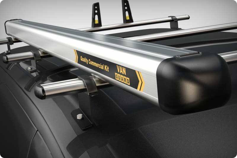

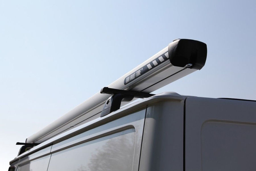

An Estate Car, and on the Roof Bars (Cross Bars) a 3 Meter Pipe Carrier, Cut down or left as bought, use inserts at both ends to be sure the bar or bars being carried do not slide.  Secure Locks on the Rack.   & Also Blacked Out Tinted rear Windows.
http://demarvan.co.uk/pipe-carriers
Then the Business / Commercial Insurance required for transportation of Equipment and covering his needs.
Maybe a Double Cab Pickup and a rolltop bed cover.
Then the vehicle is very useful for carry more equipment if ever needed, Rowing Machines, Bikes etc etc.

Should also add... hes looking at saloons at the minute, passats superbs mostly. But a standard car set of roof rails would still work with this. And, given i know a 2.4m length of timber will fit in the octavia from dash through to parcel shelf, this would work fine - no over hang of the bumpers... ive sent him your link george :thumbup:
Decided to give you a best answer george, not always sure whether your replies are being sarcky or cynical but credit due - youre bob on with the above and me buddy likes the idea too :thumbup:
One caution on the pipe carriers is that the specific one and it's end doors would need to be made for the intended purpose of transporting a solid rod, as with any free movement back or forward inside, it could under hard braking be like a roof mounted spear. If carrier is slightly longer then the bar itself, I would want a bit of wood the shape of the carrier to make it a perfect fit with no movement at all possible.

My intention for him if the option sat well once he gets a vehicle, was that we would make up a couple of "end covers" for the bar to fil it out, stop it rattling and fill the end voids. Also only get the 2.5m carrier - as its only then got 6inches to fill at each end rather than 2.5ft... also reinforce and fix the front end cap closed - make it rear load only, so less risk of it becoming an improvised missile launcher..
