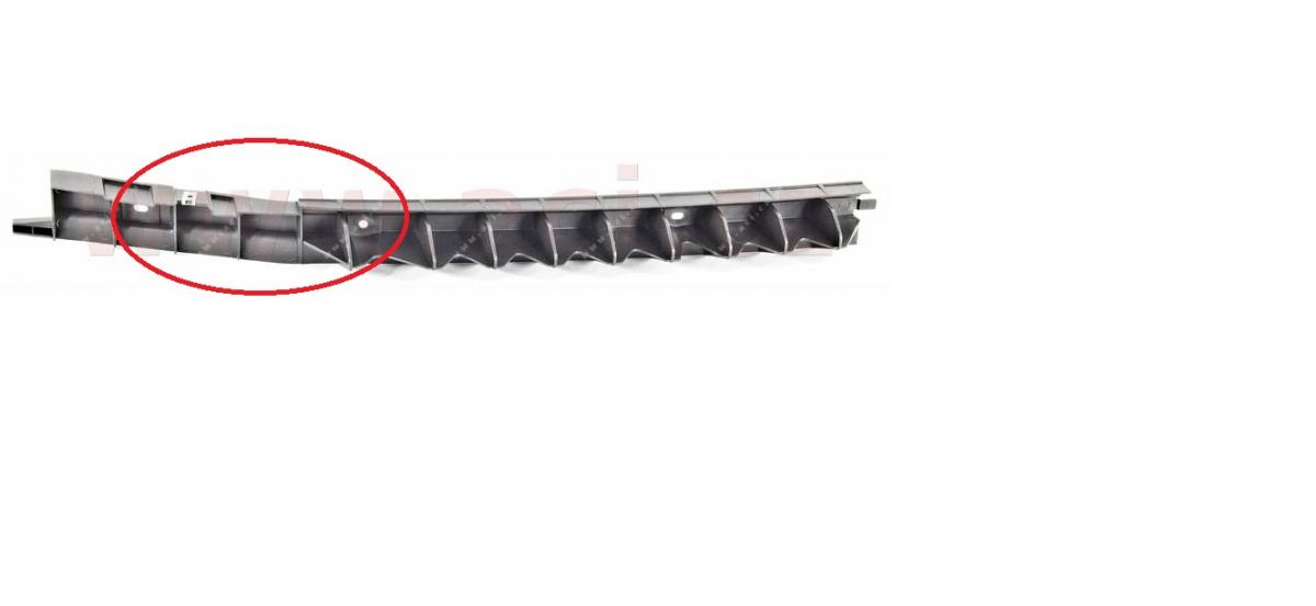

However, today when I was washing my car and notice that it does leak in boot, I was so angry and take out trim and have noticed that one peace is broken.
Bumper and boot didnt had colisions, but bumper has been taken off from car to been polished(and remove orange peel) I assume it was february or march, I dont know when exactly, bcs I didnt want to use rotary polisher on plastic(was afraid of burning paint) and my friend" did it. I assume he brake it up and didnt tell me bcs he tought its nothing serious.
I dont know maybe it isnt, but part isnt whole(I mark with red cyrcle part thats been mising).,.what you think can it be cause of problem?
I have plan to use powder and see if thats thing is causing so much problem and Im planing using silicone to minimize problem until this part arive(I had ordered earlier today but I need to wait one month to come from Czeh). Also Im planing to use silicone on rubber on left light just in case.

Nackuk had point, rear left light was some kind of loose(not upper part), and I have used powder to make sure there isnt more places to leak.
