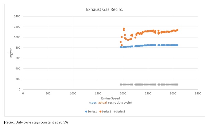

Took attached log tonight at max.  accel.
JPEG shows graph
Thinking it looks OK but not really sure what ideal should be like so would value your thoughts.
Recirc. duty cycle has got me confused though - I get it that it should be high during max. accel. It was high - totally constant at 95.5% but I would have thought it should have been 100%. Again your thoughts and experience appreciated.
Could this cause poor running?

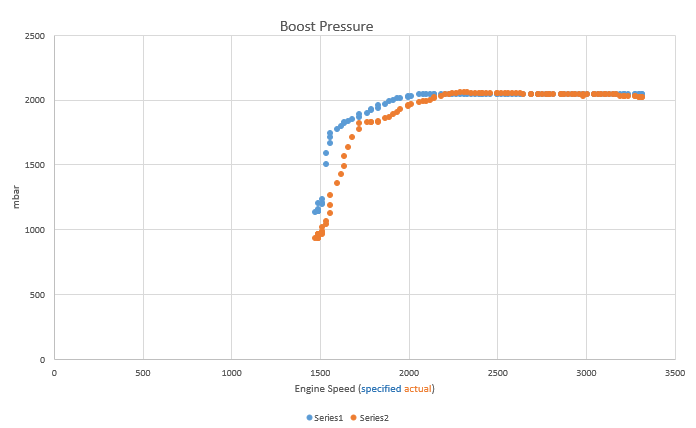

Have attached boost plot here.
Any thoughts?
Thank you
