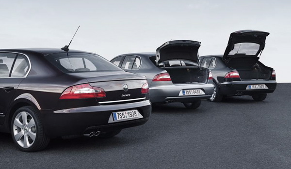

Isn't the radio antenna on the rear window?
Yes the shark fin is for the GPS and mobile phone use. The radio aerial is the vertical bars in the back window of the twindoor. (The ones that look like they are part of the demister element).
The earlier twindoors had a different style aerial with a normal style aerial mast sticking out of the sharkfin which was later changed from 2010 onwards (possibly MY11 onwards) to the latter style of having the radio aerial on the back window and the gps in the sharkfin.
I've attached a picture of the original style mixed radio/gps aerial/sharkfin.
