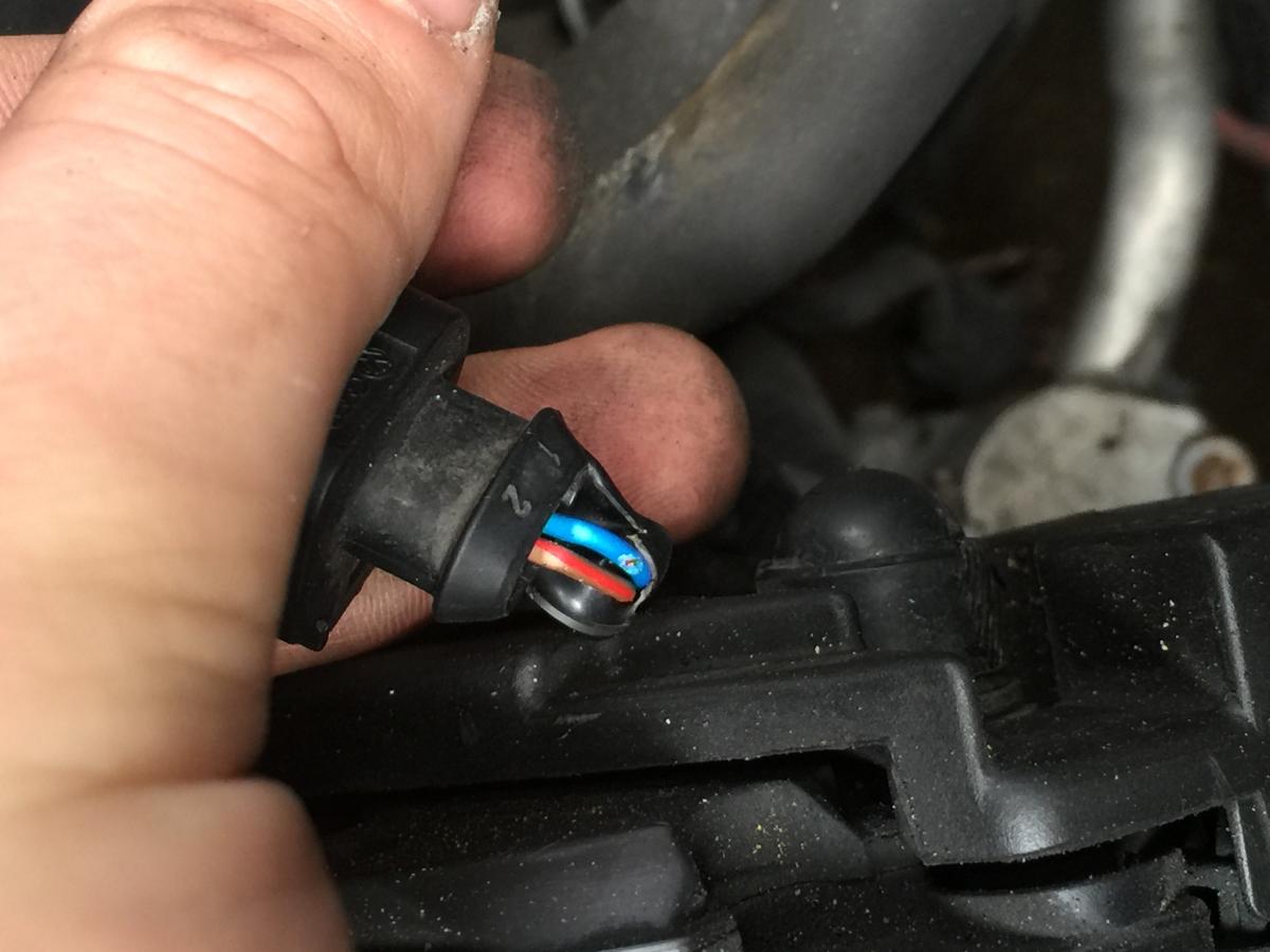

Found a tiny Nick on the alternator plug wire

With that connector not plugged in, switch on the ignition and see what voltage you can measure by probing into that nick (other meter probe on engine metalwork or battery negative).
Does it look like the wire strands are broken or corroded inside, looking through the nick?
Edited by Wino
Measuring at 00.3 00.4 Nick is very tiny hard to sell if it corroded or wire broke but the wires are like crimped

So, if you follow the cable down/across from that connector you'll find the connector pair on a bracket on the front of the gearbox, where that blue wire, and possibly also the other one will be broken on one or both sides of the connector pair.  Repair there in a waterproof manner, and all will be well again.
