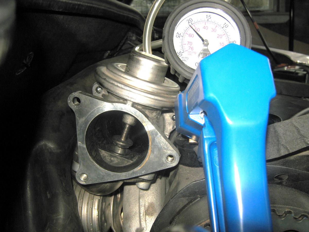

Coincidentally as you were typing the above I was out cleaning the EGR valve.
Had not done this myself previously as garage said they had done it - still pretty caked though. I guess by 'clean' they meant squirt something into the induction system and hope for the best. I removed the valve and did a more thorough scrape and scrub with carb cleaner.
Attachment shows it refitted doing a final vacuum test on valve.
BTW Starts to open at 11 inHg  fully open at 21 inHg
Not tried it out yet so we will see how it goes.
