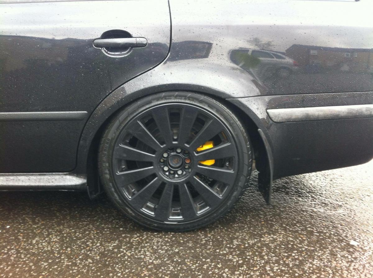

Finally got the car finished, the wheels are 18x8 ET35, there is a few mm clearance but probably couldn't drop the car much more so will see how the car sits once the shocks have settled. Also impressed with the adjustable coilovers, very good quality. Also changed the lower arms as well as the top mounts and had fun trying to get the rear bush bolt on the arm out, super tight, had to buy a Impact gun to get it out...
Edited by BusyBeingBorn
Sneak peek at the rear, happy with the ride quality so far, had lowering springs previously and the ride quality is very similar.
Plan on getting the arches rolled in the next few days and fitting some 5-10mm spacers to the front to give me more clearance from the shock to wheel and then I will be able to go lower on the front.
