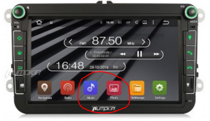

Are you able to take a picture of your home screen? You are looking for a physical app that is to do with the bluetooth. I believe it is the phone app if that makes sense. I can't really explain it in any other way than that. Then once that is open take a picture of that screen as well so I'm sure you have the same app as I did. From there, there should be a list of tabs down the right hand side. In one of them it displays the head unit's current bluetooth connection code. This code should be able to be clicked on and set as desired. Allowing you to connect your OBD2 dongle.

Is this what your home screen looks like?
On my old unit it had it like in the picture below. In the middle where i've circled there was the music app and then there was also another bluish coloured app which had a bluetooth style symbol on it I believe. If it's missing like in this picture it might be mixed in with all your other apps.

Yes mate it does look like the above, only it has Red Backlight buttons not green.
I do know the blue logo your talking about and its on the front screen in your red circle.

Looks like we're on to something now. Let me know how you get on. I will aim to remember to logon when home this evening to try and help you get this sorted tonight.

I found the PIN and changed it and its all working now thanks.
