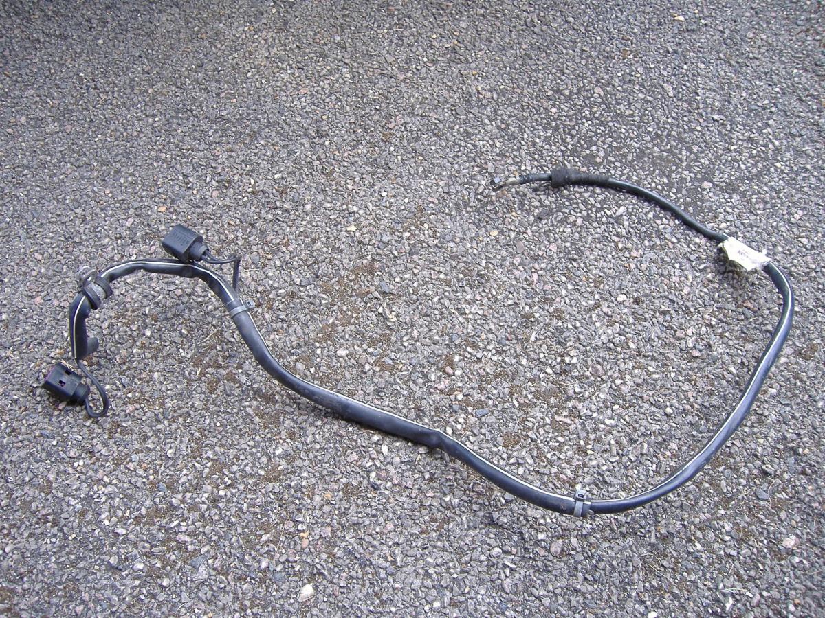

Basically he is saying don't drive the car unless you have to. What you are getting is excessive resistance in the wire, which is causing the heat build up (essentially the electrons are encountering a bottle neck in the wire, causing them to back up and create heat). What can happen, is that if it gets too hot, then the insulation could potentially melt and cause an under bonnet fire - destroying the car. Best option is to take a picture of the cable in question, and post it in the thread so someone can ID for you to be able to get a new one.

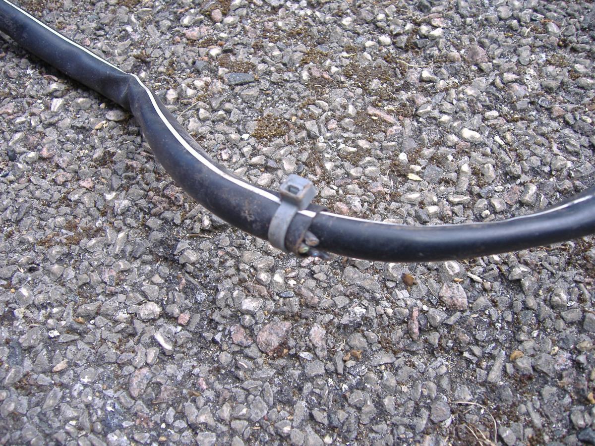

It looks like this
audi-tt-8n-mk1-1.8t-alternator-battery-wiring-loom-air-con-pump-harness-98-06-[3]-5693-p.jpg

I might have one of these spare as well. I've just got a box full of vRS engine loom. Pulled it out, took one look at it, got scared and rammed it all back in again! Can have a look if you need one.
Yeah if you got one that will be great.
I'll have a look on Tuesday for you if you aren't sorted in the mean time, via Jason or otherwise. £15-odd on eBay.
The good news is that I have the alternator sub-loom. The bad news is that someone has hacked part of it off, the bar steward! Therefore, I can't sell it to you, but if you pay for the postage, you can have it and make what you will of it.
