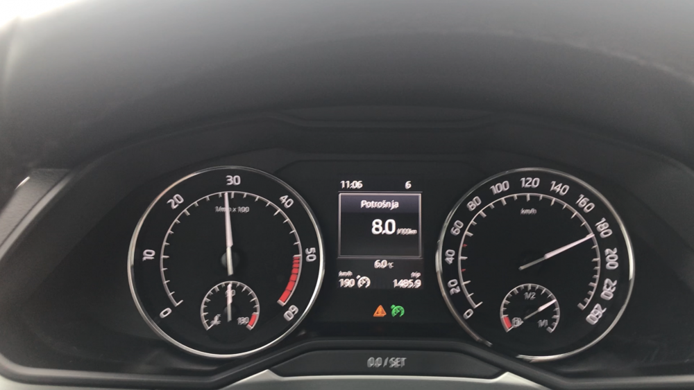

i make a picture where You can see my problem. Also, I can’t set tempomat more that 190km/h, but my car can’t hit that speed.

The warning symbol displayed on your dash, are you just out of windscreen wash fluid or is it something more serious?
agree with Sagalout
speed limited according to the dash picture provided.
Pages 38 and 178 in my english manual.
Waring is for wash fluid.
