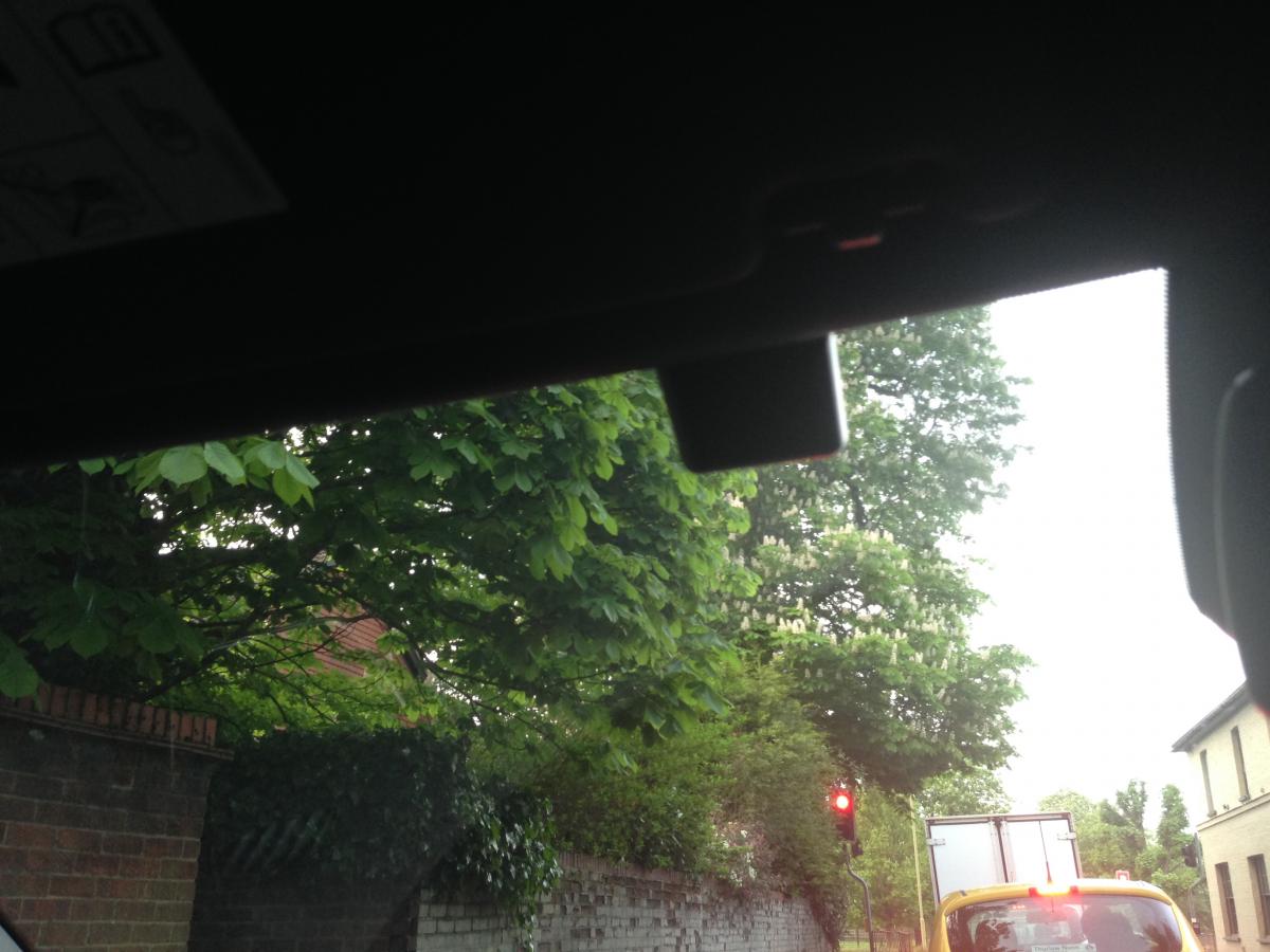

I fitted it myself, and a simple install. Removed the CD player in the glove box, and disconnected two cables and then joined the two boxes in. Had to dismantle the side of the car to fit the gps aerial on top of window screen, but easy enough.

In my case I put the GPS antenna puck under dashboard, locked on top of a metal beam supporting the dashboard. Works well enough.

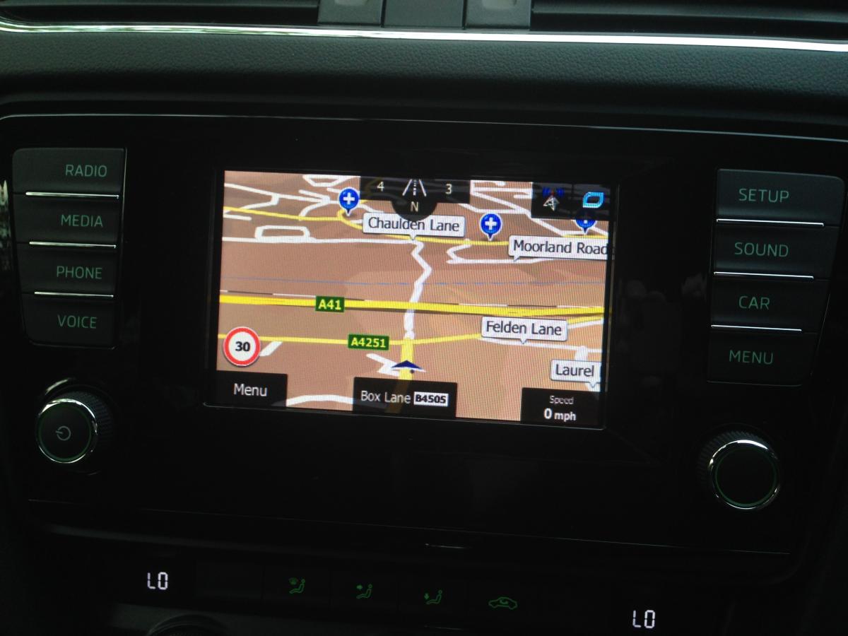

Pics of nav in progress. I don't have any scaling issues, my box is set to 800x480 and works a treat

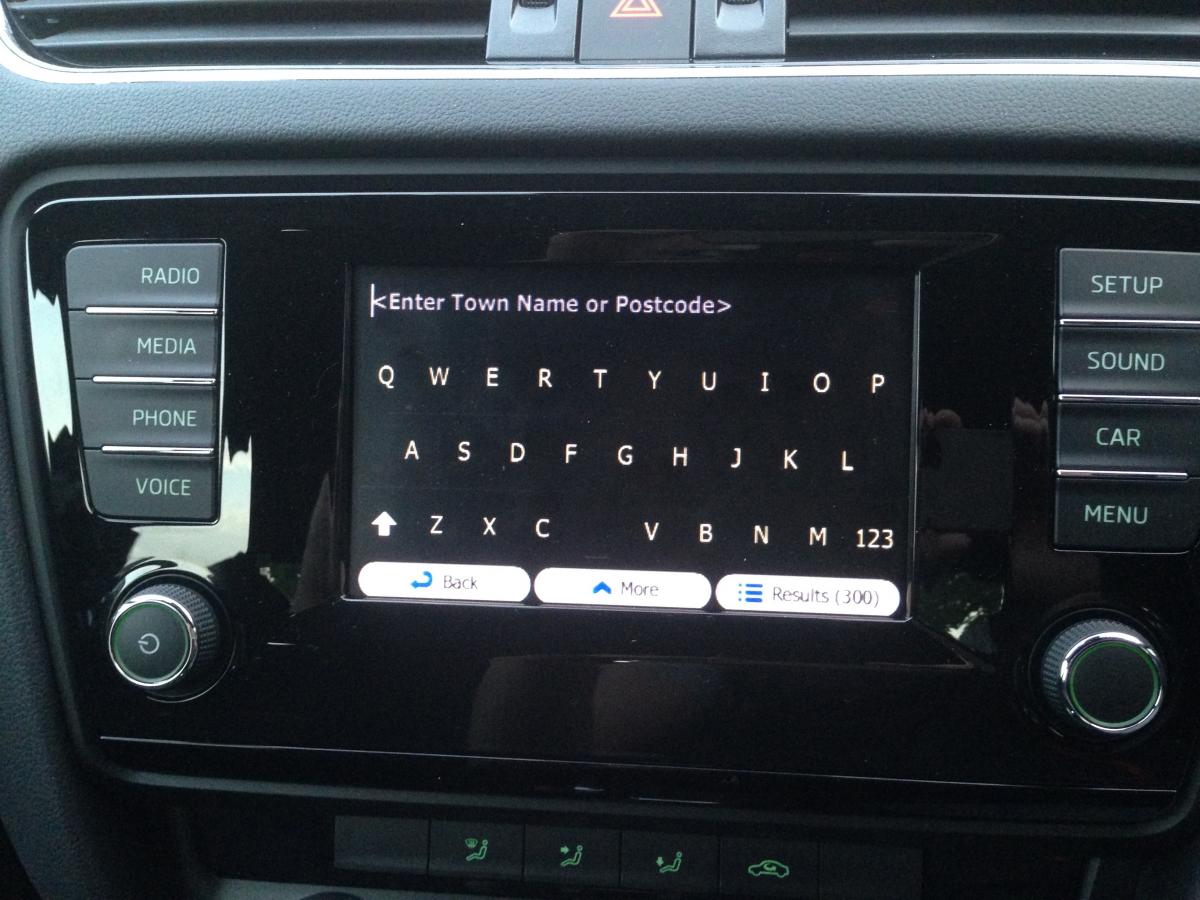

Full postcode search.
