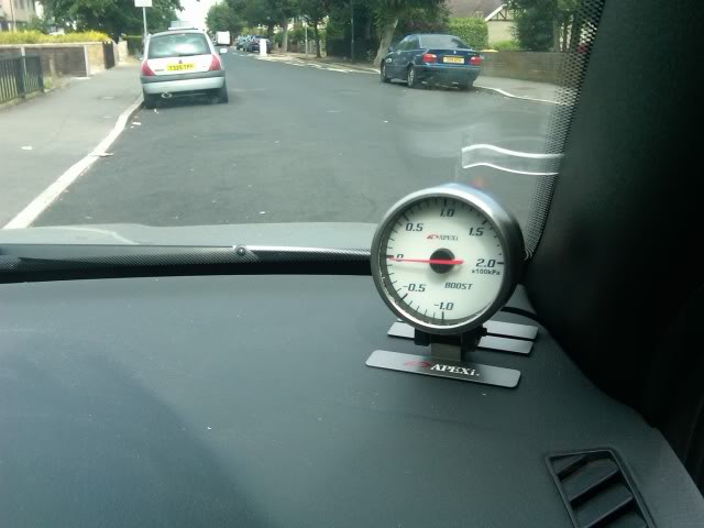

can anyone help me..im going to fit a boost gauge to my vrs dash and was wondering were to run the pipe to...  oh and how do I get it behind the dash...
Edited by CraigVRS1
someone on here helped me loads :) this is my engine bay, you can see the T-piece where I connected the pipe, and I fed it through the grommet by the pollen filter....
I used the grommet by the pollen filter as well. If You feed the pipe there it'll coming out behind the glovebox somewhere. (tried a few times before I finally found it [emoji4] ). After that it's up to You where You wanna place the gauge.
