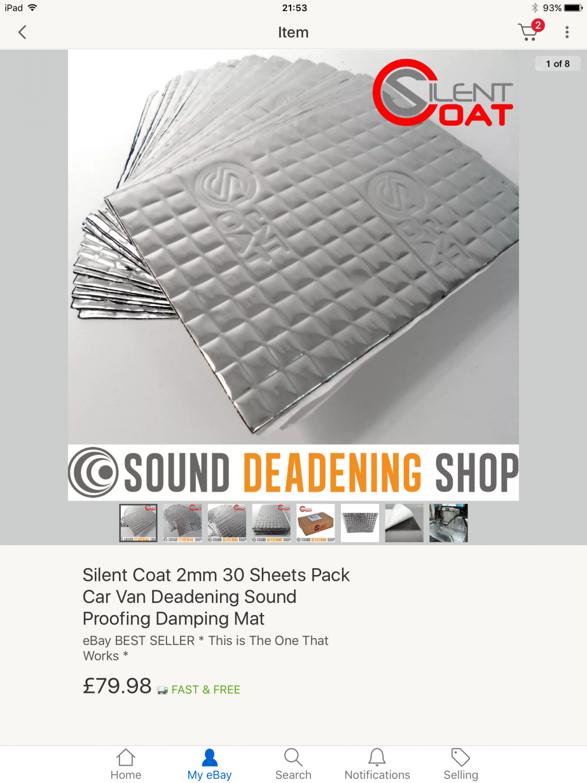

I brought silent coat from eBay as per he pic. It was easy to fit and has taken away the noise on the rear of the car that I was experiencing. It was adhesive so just had to stick to flooring and cut out to shape of vehicle
