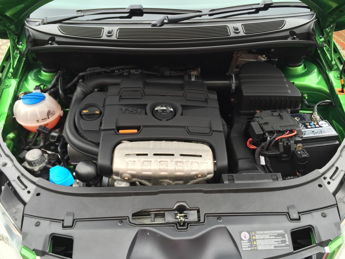

Has anyone painted the outer faces on thier Vrs manifold heatshield?
If so was it successful or stupid........
Just wanting to tidy the heatshield up as its looking tired and the rest of the engine bay is mint!

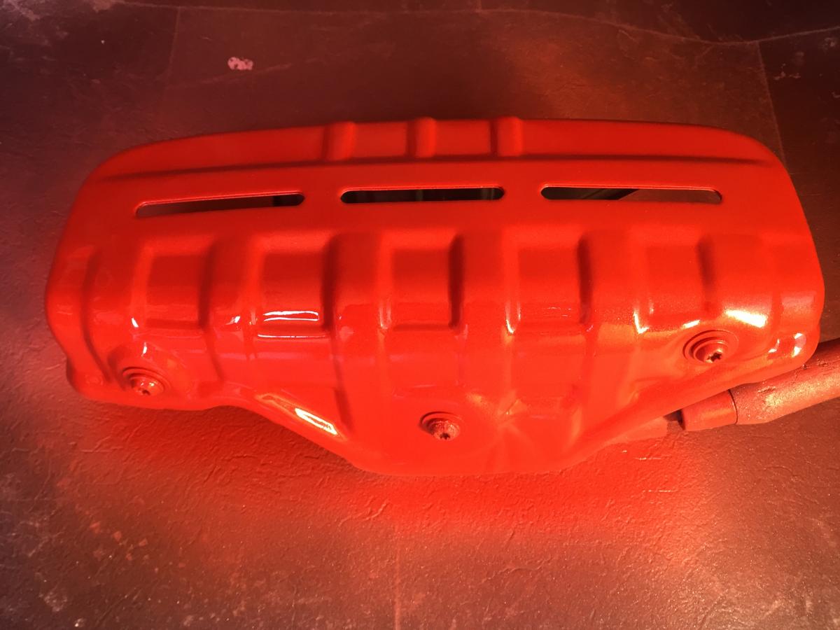

So I've gone and painted it red.... Seen as I have gone with the luminous snot green/ red theme on the car!?!
I'm liking the red :) might give it a go myself.
I'll get a picture up once it's dried and back on the motor!
Only thing is its drying matt, what with it being high temperature paint.
Looks good in sunlight though!

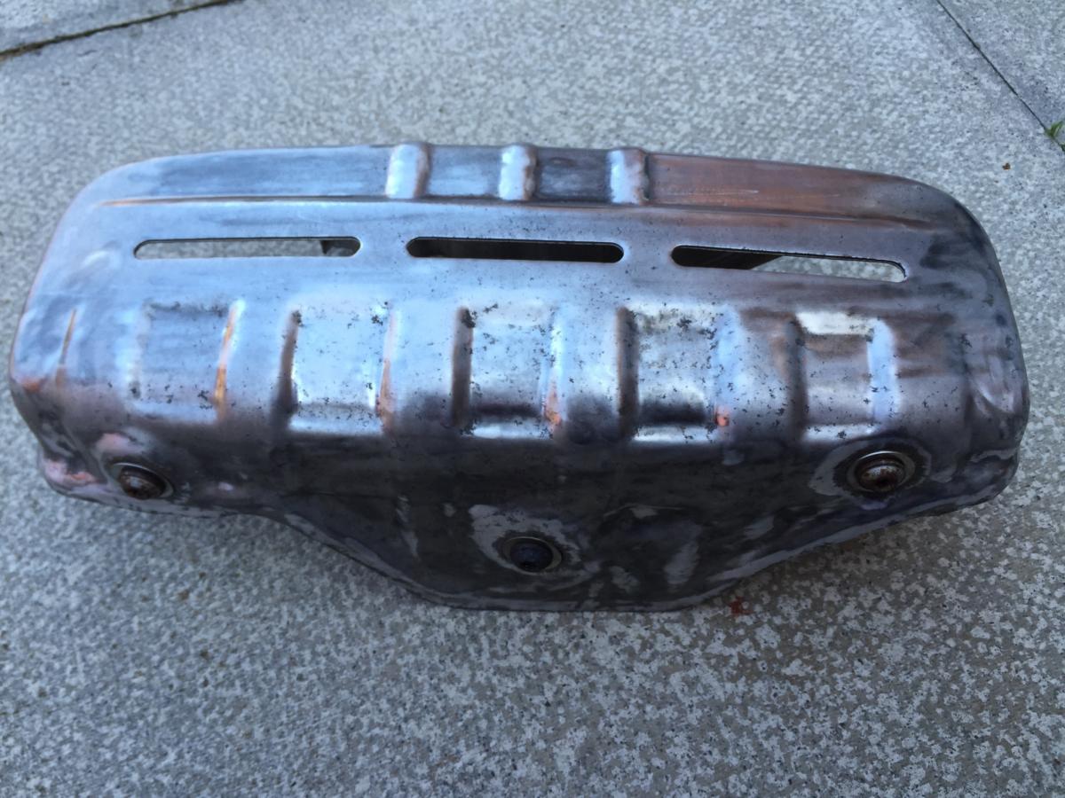

Take the plastic engine cover off first, the you'll see two m10 nuts holding the heatshield on. Take those off, then remove the three torx bolts on the front of the manifold cover. Be careful if they're rusty!
I gave the heatshield a good scrub with a brass wire attachment on a Dremel to clean it up, getting rid of the crap on the face of it.
Then wiped it over with cellulose thinners and sprayed it with Halfords very high temperature paint.
Took a wander over to my local branch by pure chance today and they had in a few colours- such as metallic red... Hence being a tart!
I gave it about four coats leaving 15 mins between, then after it dried an hour or so bunged it in the oven to cure- slowly took it up to 120 degrees for an hour. The less the wife knows about that the better ;)post-136973-0-67875800-1463257366_thumb.jpegpost-136973-0-67875800-1463257366_thumb.jpeg

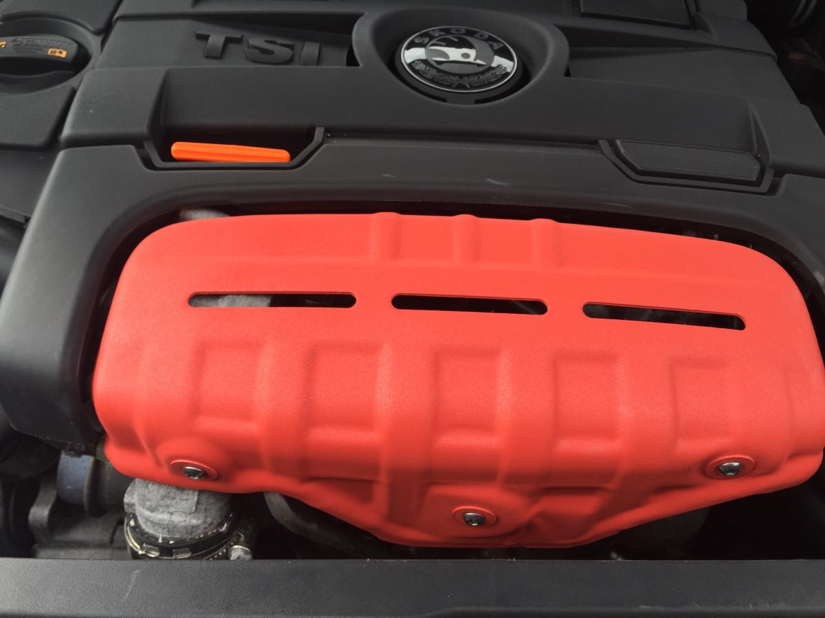

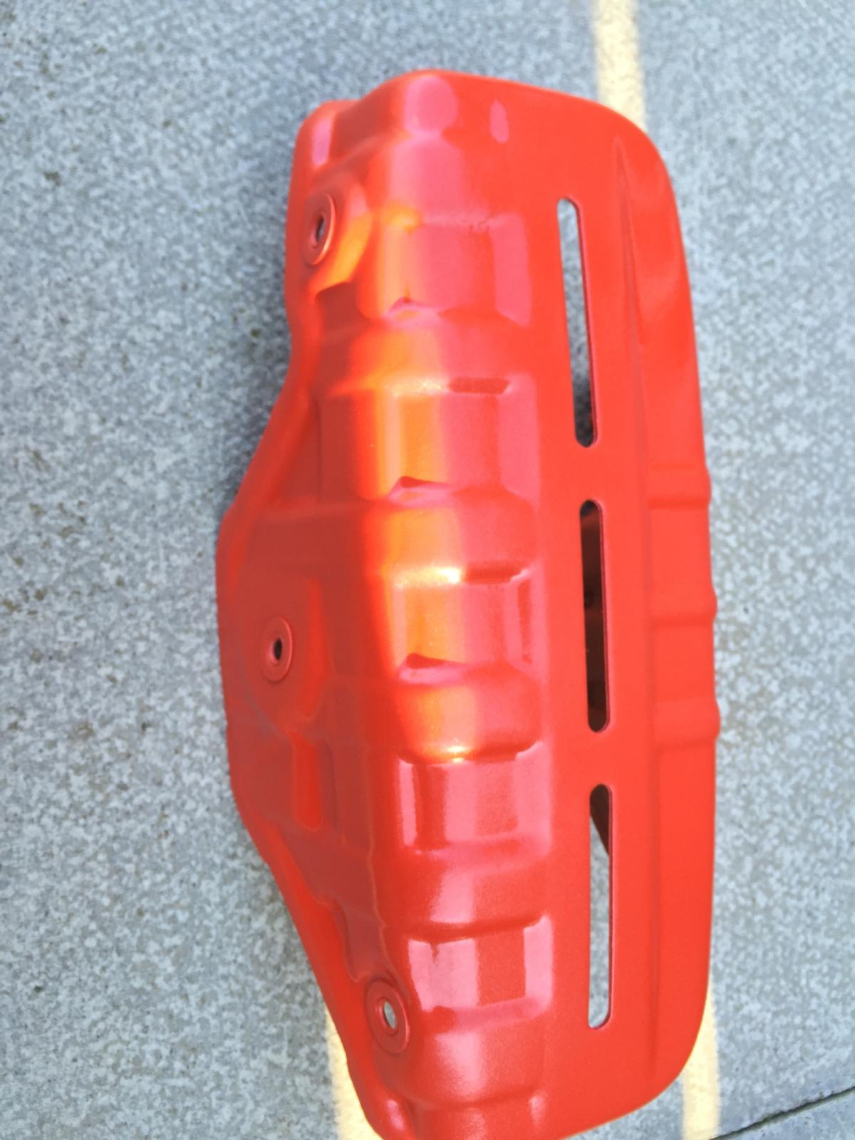

And the finished job.
Really liking the matte finish actually.
You can get clear VHT paint, do you think a couple of coats over that finish would make it glossy?
Sent from my SM-G920F using Tapatalk
It probably would do, worth a try I guess.
I'm leaving it as it is for now, see how it lasts over a little while.
