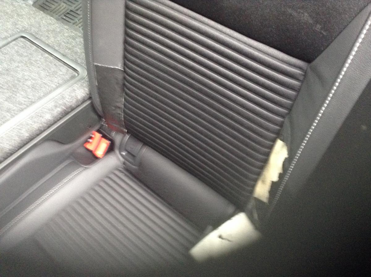

post-115308-0-17001100-1463166495_thumb.jpegpost-115308-0-17001100-1463166495_thumb.jpeg
Took a while but managed to upload a poor photo. The left hang damage is smaller and has gaffa tape over it. So I need to see if I can get the back rear back rest off and knowing how to do this or getting somebody who will repair it is not easy

Wow that's gone right through to the foam.
Maybe try and get a used VRS seat from a breaker's yard.
Have a look on eBay search for Octavia vrs seat breaking or try filling out www.parts gateway.co.uk search and they will get back to you with prices.
If you lift the boot floor and lift and tilt the seat bases, you will see the securing bolts.

I had a look at the boot section.. I lifted the boot floor. I could see the two plastic pins on the runner rim.... Do you pull these off to reveal the bolts for the single seat back to come out or do you go in from the cabin part... I am quite technical but find with cars especially manufacturers put things together for speed rather than engineering and I don't want to break anything or spoil the car...
Any info appreciated thank you
Al
Lift the seat base and have a look under there also.
Is yours an estate or a hatch?
On the estate, pull the front of the seat base up, then you should be able to pull forward and then fold down into the foot well. You should then see the backrest securings.
