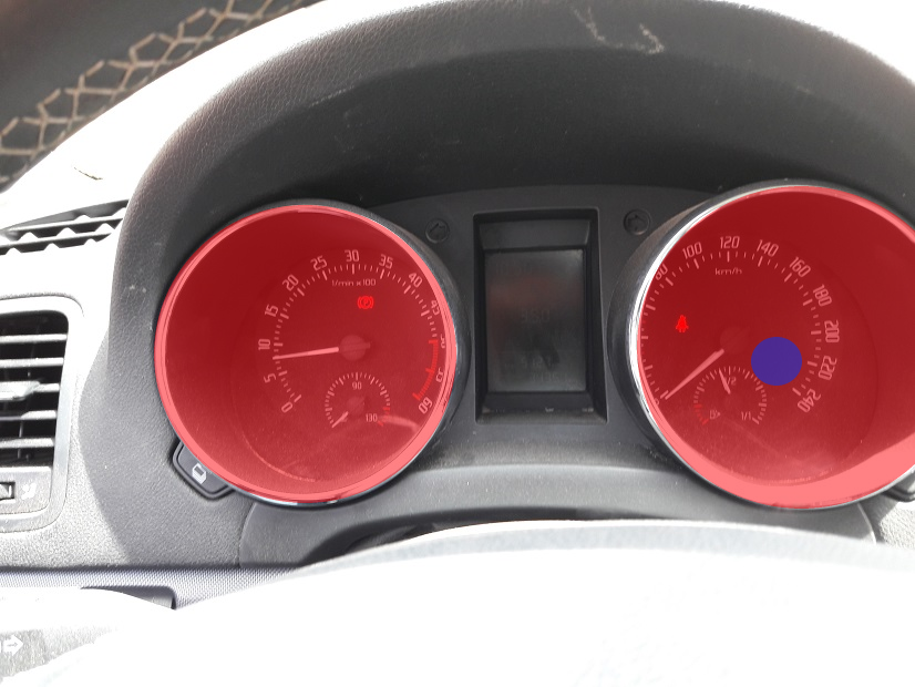

For the second point, it's YES. for the first, Can you please indicate me exactly the zone of cleaning,
Just clean the two dial faces. I've marked them in red on this picture, the light sensor is typically somewhere in the area I've coloured blue.  Be warned the plastic tends to be quite soft so you need to be careful not to scratch them
