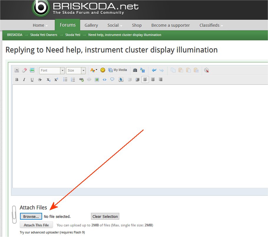

Attach Files
Browse, to the picture you want
Attach this file
