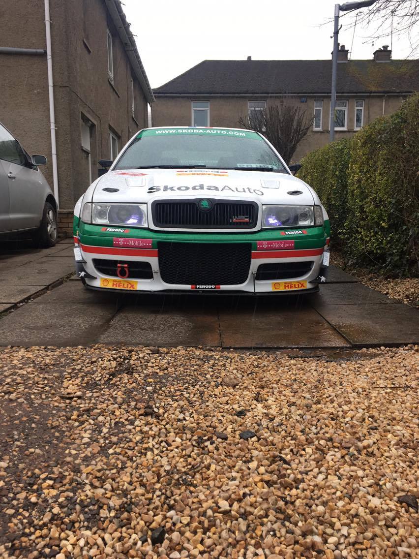

Bah so stickers never came before the meet lastnight, was hoping the would have to compliment the rest of the good work, so anyways my first meet with it, some pics as decreed by Briskoda law
Won a box of krispy kreme doughnuts for :Edit runner up for best car of the meet :D, I wonder how :S, there was an other Briskoda member there in a Mk2 limited edition I've met before but sadly never came over :S

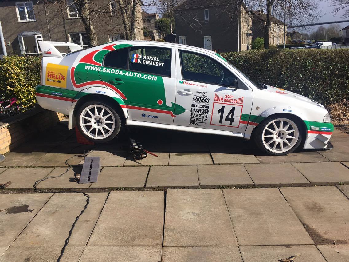

Clutch now done and converted to single mass flywheel, so it can get boosted now :D
Complete straight through exhaust now, as I took cat back off my tdi for it.....

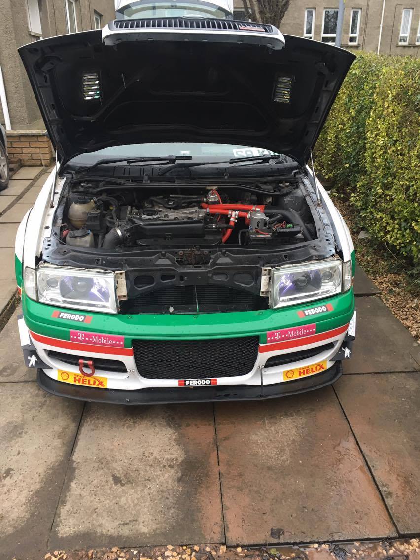

So done the clutch yesterday and all was well, put humpty dumpty back together and started it, checked the clutch and then got the dreaded oil beeping, so checked oil level, that was fine, so i though maybe so crap had made it's way over to the pick up pipe, so off the sump came, untill i got to the 2 inner bolts at the flywheel, and being that this one is a single mass now this particular make never had the slots in the flywheel to get better access to the 2 nuts, so improvised with ball end allen key and final won, to my surprise the oil pick up was fine, some little bits of crap but nothing that would make oil warning light go off, so scratched ma head, at this point it's now 2 am, can't start it up as mega loud haha, so had to wait till this morning when heading out to go to Cumbria vag, so oil warning again, thought to myself there is no way that oil pump is goosed as can't smell any burning, so i put it down to a loose/broken wire, traveled 50 miles to meet up with convoy to head down to the event and that's when i stumbled across the problem, the wire was halved, god only knows how so, pair of snips and temp mended, job done, day saved and went to Cumbria, dunno who all went from the forum but met only 1 other member, Mr Dean Jon Andrews..... well Sir it was a pleasure to chat with you and hope to see you at Vag tuner..... Anyways enough of this novel crap, pics......!!!!!!!!

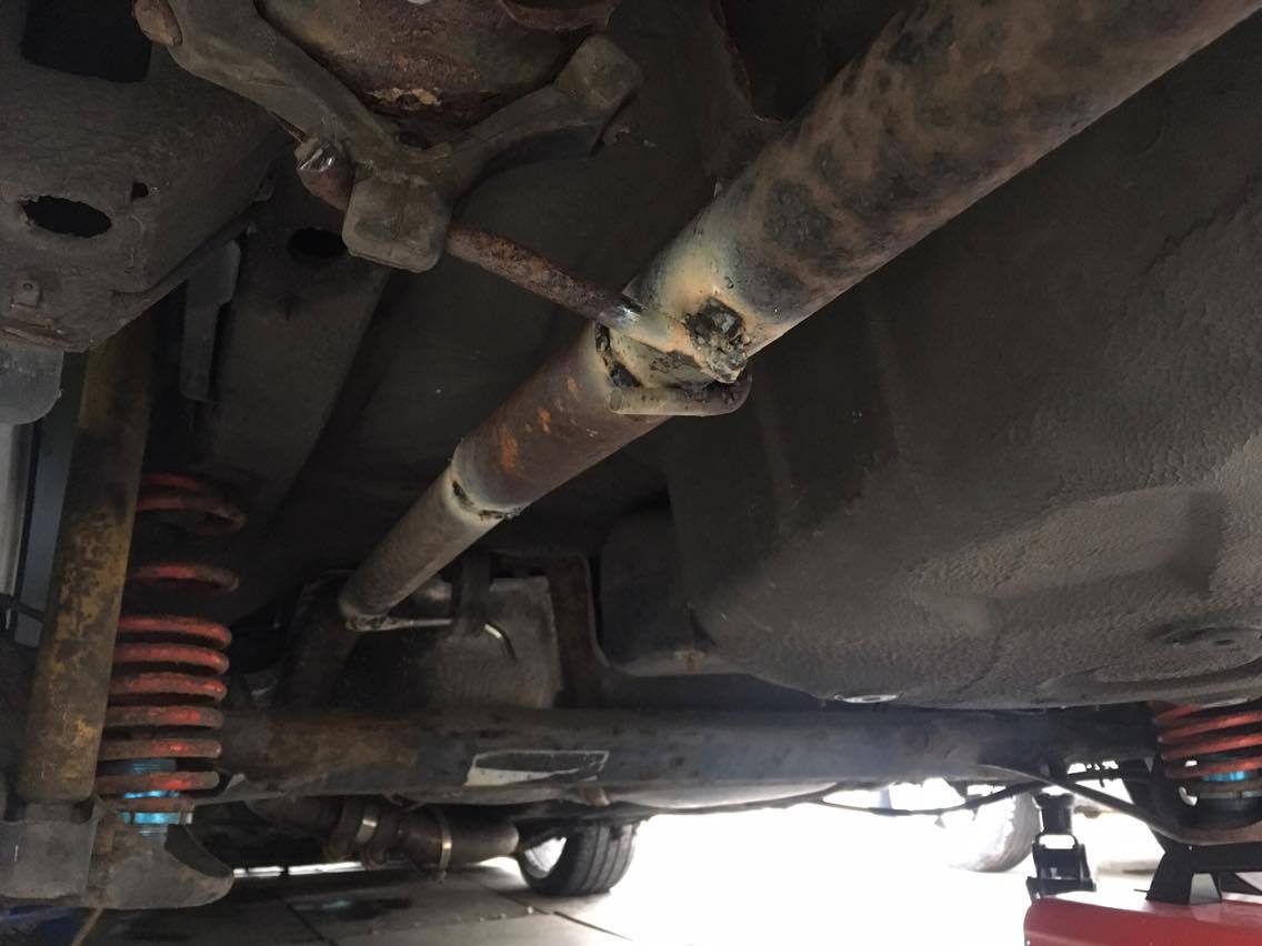

Sorry bud, Aint been able to get access here for a little while and since it's pritty much dry here I decided wasn't going to boher with the thread much, Anyways shes still alive and kicking, Had it up at crail last year for a bit of fun, since then it's been sat up and nothing much has happened, but in the last few days it's covered about 150, and went to a local car meet, just now fixing little issues that's arisen as it's been sat up, push button start has now decided it's not wanting to play ball, but rewired it onto the key again for the time being, exahust snapped so had to throw it back together, typical Scottish weather preventing me from doing it quickly and had to spread the reapir throughout the day due to the weather
