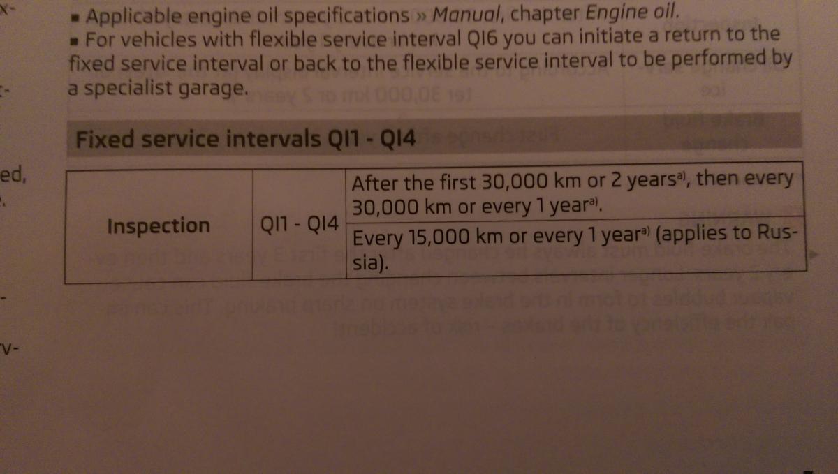

When i bought my 2015 Citigo i read the manual about the service intervals. To me it reads that the first service is at 2 years or x amount of miles which to be honest i thought was a long time to wait for the first service. However, the "INSP" indicator has just started coming on when i start the car. I haven't reached the stated mileage for the service, have i read the manual wrong or is there something else going on?

This was the part of the manual which threw me. To me it reads that the first service is 2 years or 30,000km unless you are in Russia, in which case it is one year or 15,000km

Yeah I found that sticker which does indeed confirm is fixed interval servicing. But like I say, the manual seems to suggest for the fixed service intervals the first service is at 2 years.

Now I wonder why they even mention flexible intervals in owner's manual, if there's no such possibility.
I see.
The whole section is just copied from other manuals.
