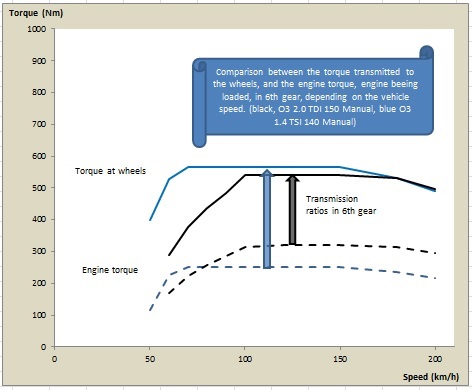

On the 2.0 TDI 150, with the manual gearbox in 6th gear, the max engine torque starts to be available at 100km/h (62mph).
This should not be much different with the 6 gears DSG.
In the same exercise, the 1.4 TSI 140 would allow shifting in 6th gear from 70km/h (43mph).
See the graph(*) below, showing the engine torque on one hand, and the torque transmitted to the wheel (what makes the car accelerate) on the other hand.
Comparison done between the O3 2.0 TDI 150 Manual (black curves) and O3 1.4 TSI 140 Manual (blue curves).
Your observation is the consequence of the quite narrow usable rev range of the diesel engine, and the longer development of its transmission, needed to cope with its high engine torque.
Transmission ratio in 6th gear is designed  to bring torque values (thus power) to the wheels close to the one provided by the petrol engine at high speed (>100km/h).
The consequence for the diesel  is a lack of torque in 6th gear at low speed (below 100km/h and 1750 rpm).
For more flexibility, and ability to drive on the torque at low/middle speeds, you should have bought the petrol.
(Details: Curves are showing torque values depending on the car speed, not revs.
That's the reason why, having different ratios in 6th gears, the engine torque curves are more or less translated to the right.
For a selected gear, here the 6th, there is a direct translation between the engine rev and the car speed. This allows, knowing the engine torque curve based on the revs, to build the engine torque curve based on the car speed. The torque transmitted to the wheel is a direct translation (homothetia actually) from the engine torque based on the transmition ratio)
