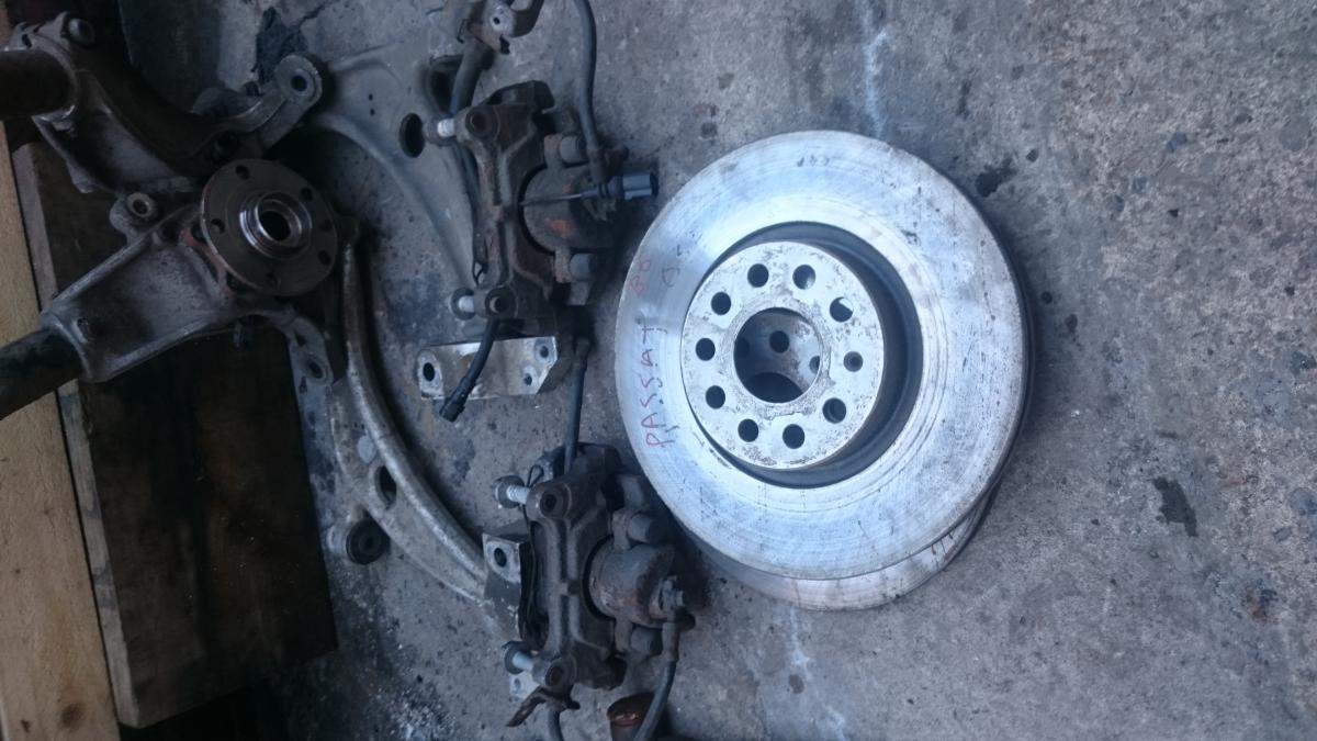

Lowered with Passat hub's
weird stretch look

What did you do with the old hubs?
I'm going to do a brake upgrade but mine has the caliper carriers cast into the hub...
They were weighed in i'm afraid.Sorry
Best bet is do what i did and buy the legs whole.
Edited by vrsRo55
No worries cheers.????
The cast in carriers are a 50mm strut.  If you are doing the upgrade you have to do the struts & the hub.  I can't remember if the bearings are interchangeable.
You would be better off trying to buy all the bits from a wreck.
For the amount of faffing, it might be easier to fit a premium pad & rotor.
Cheers @brat1.8t will just go the route vrs055 and collect all the bits together,

I managed to find the nsf also so now I have the full set up cheep as chips  :thumbup:

My front end arrived today I'm over the moon..
Alloy hubs and arms calipers have been rebuilt recently and the pads discs and wheel bearings are brand new..
And best of all the discs are 310mm...
