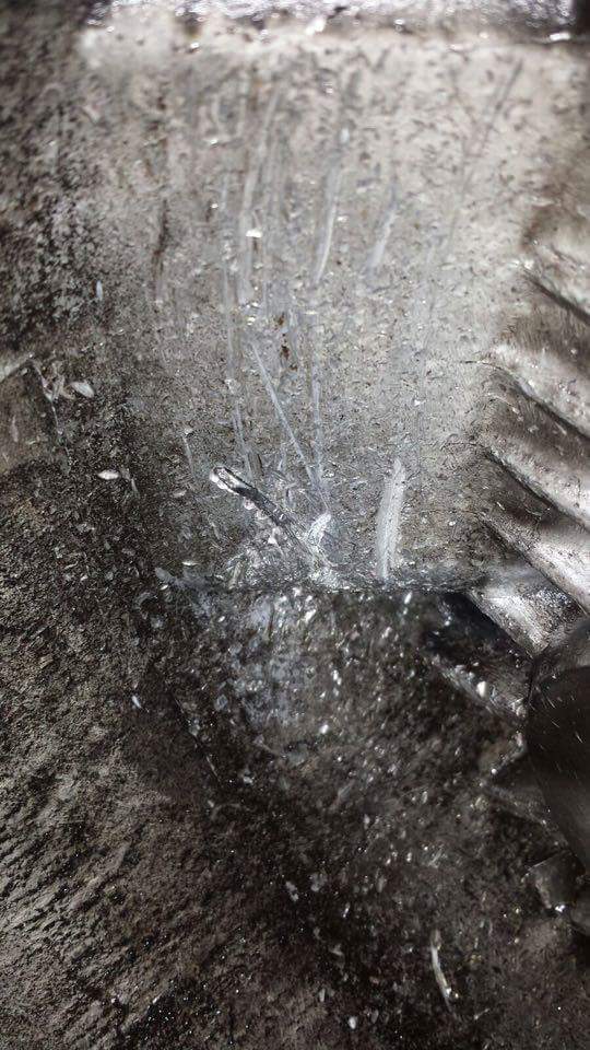

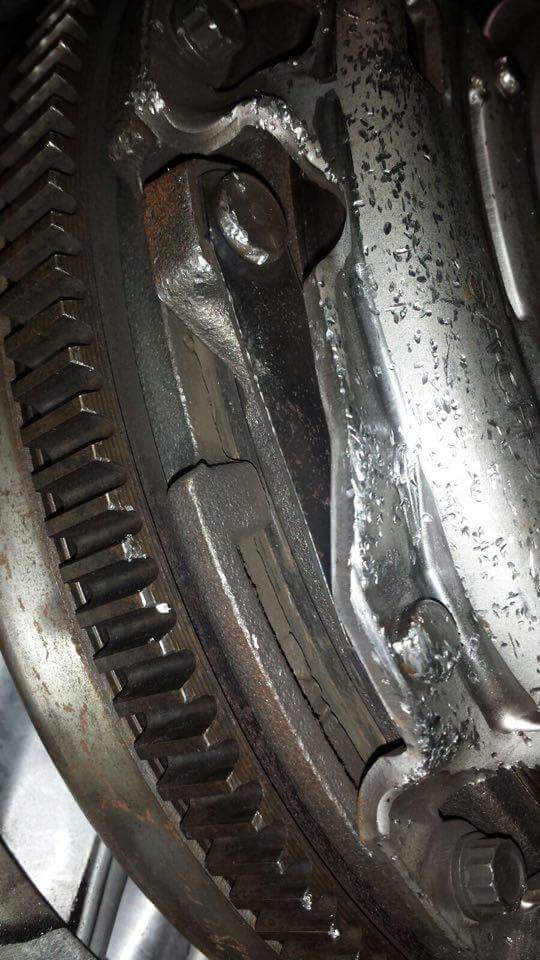

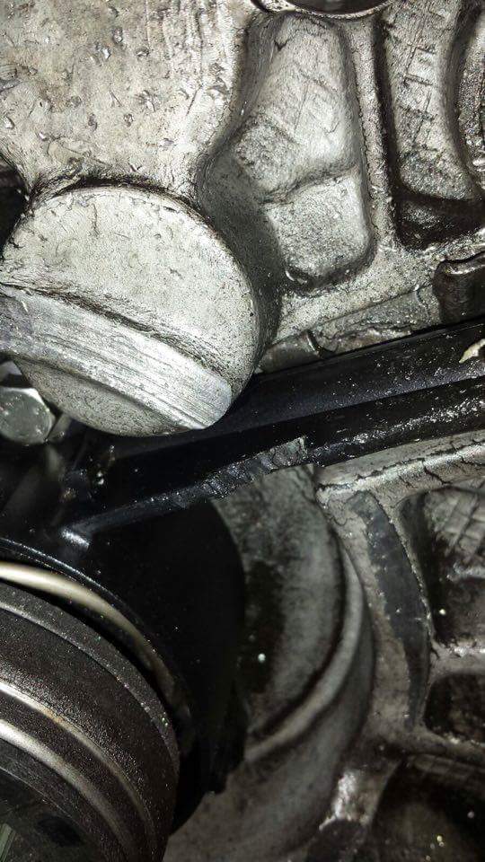

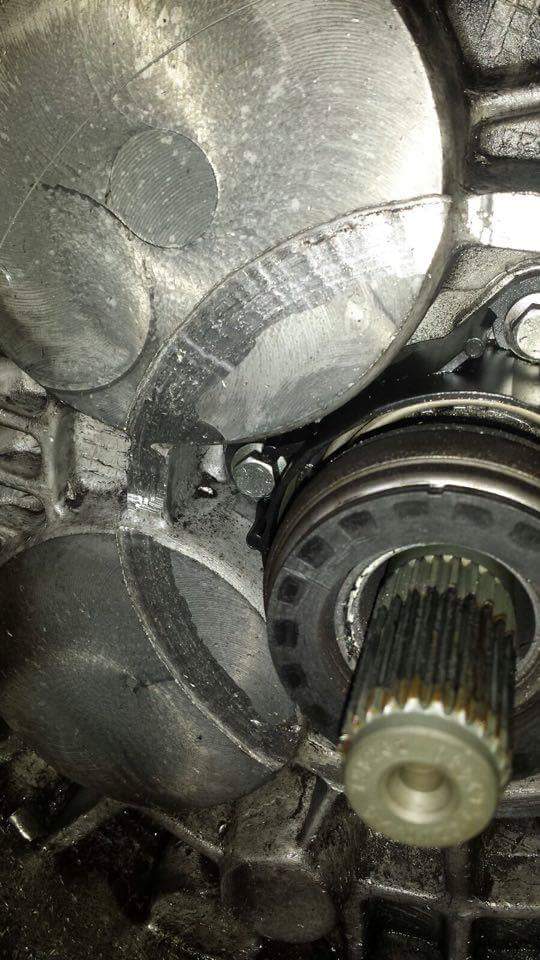

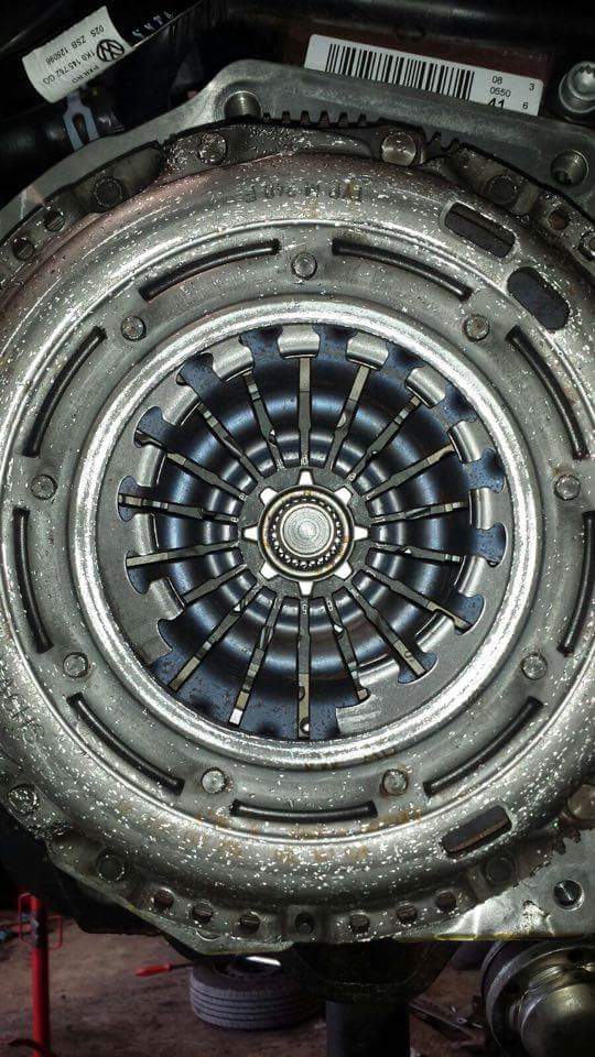

Here's a few images of the failure.  The damage to the gearbox casing means it is likely to mean fitting a secondhand gearbox is the economical option.  A new one from Skoda is going to be silly money (I expect, garage is awaiting a price).  In total, I'm expecting a bill in excess of £2k.  All down to part of the clutch disintegrating.
Whilst I appreciate it is out of warranty, it is damn annoying that the failure of a part like this, which I cannot fathom how it can occur due to any inadvertent misuse of the clutch that I may have been doing whilst driving, leads to a massive repair bill on a 4 year old car.
Anyway, the pictures show the chunk of the clutch that has come away, and machined a bit of the gearbox housing, before ultimately detaching completely, rattling around the bellhousing before puncturing the gearbox casing.  What I find odd, is that other than the clutch not working for a few hours and then working perfectly again, I heard no rattling, felt no vibration, nothing.  I suppose it goes to show how well isolated modern engines are.
