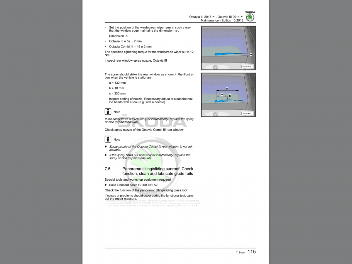

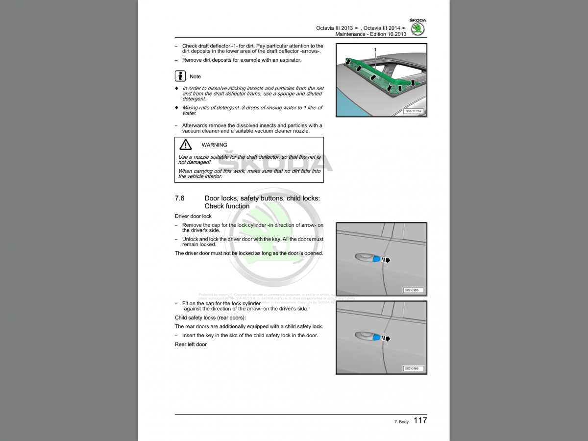

From the maintainance manual. post-139828-0-61449400-1466579893_thumb.pngpost-139828-0-17615500-1466579909_thumb.pngpost-139828-0-11900600-1466580058_thumb.png
Edited by KjetilRos
Great, thank you. :)
I wonder what they mean by a lubricant paste?
That answers it, thank you.

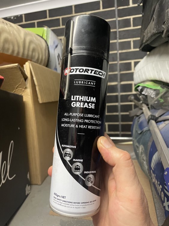

I can’t remember where I was recommended Lithium Grease.
Diving into give it a ‘service’ tomorrow.
How did this go for you?
