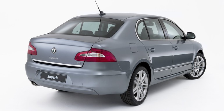

Aren't the rear quarter panels (rear wings) also a different around the new light clusters? Being double skinned too, they'd be a nightmare to replace. Nightmare all round really!
They are the same, I guess the concerns you had on cost was one shared by Skoda, hence minimal tooling changes for the relatively short life of the FL model...
