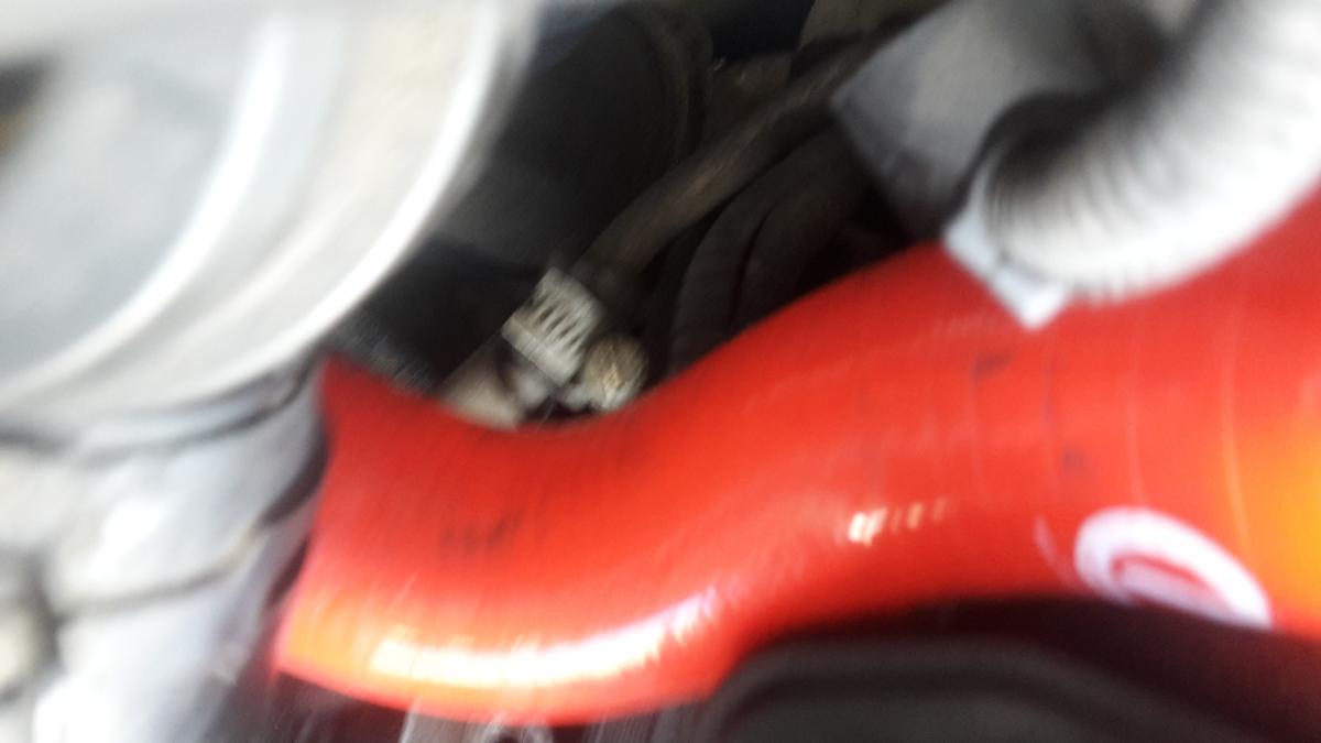

Pipes from Creation due in on Monday/Tuesday, with a roll of vacuum pipe sitting at the garage just incase its needed. Hopefully solve this problem in one go.

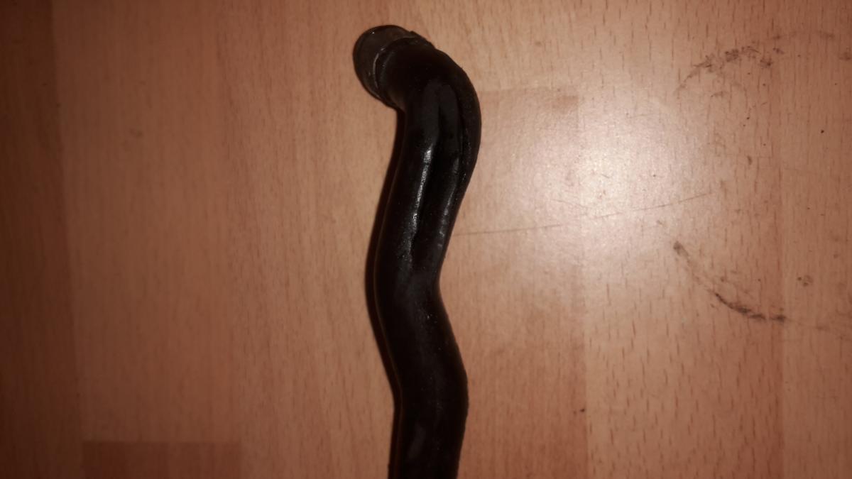

Culprit found. Now to see how it goes...
Pipe that goes from the manifold to a small t-piece. Just replaced every pipe in that sequence. Feels more responsive and no EML light so far, and its due to come back on.

Still no fault codes. Wish I'd gone straight for a OCC instead of fitting these pipes though, as I can't get the image of the horrificness of what was inside them out of my mind. Problem is the OCC kit I'm after comes to ~£180 and I've spent too much this month already (these pipes, caliper, timing belt cover, oil pick up, service)

**** photo but found another split pipe, down the back of the TIP. Was having a quick preview of the deletion jobs while fitting a new air filter.
Car feels even quicker and pulls beautifully. Funny how much difference a small pipe can make.
