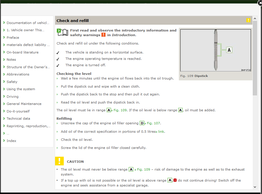

Interestingly (if you're into such things), I picked up my new Citigo yesterday and am looking through the handbook at the moment, so I've skipped ahead to the section on refilling the oil and the OP will be relieved to hear that they must have updated the text since his was printed, under refilling it now says:
  • Unscrew the cap of the engine oil filler opening
  • Add oil of the correct specification in portions of 0.5L
  • Check the oil level
  • Screw the lid of the engine oil filler closed carefully
The only thing that surprised me is that it says to check the level when the engine is at operating temperature and I'm used to checking when the engine is cold.
And in the section on the TPMS it says "The system cannot warn in case of very rapid tyre inflation pressure loss e.g. in case of sudden tyre damage" - so it's there to warn of slow punctures, if you have a sudden blowout you'll probably notice other symptoms before a little yellow light on the dash.

Well it has been updated, since the dipstick in the diagram looks exactly like the one in my car and only has an "A" range; the instructions say to top up the oil only if the level is lower than the indicated range, so in this case adding 0.5L would probably not lead to overfilling.  I've attached a copy of the relevant page or you can check the latest version of the manual yourself at http://www.skoda-auto.com/en/mini-apps/owners-manuals/
