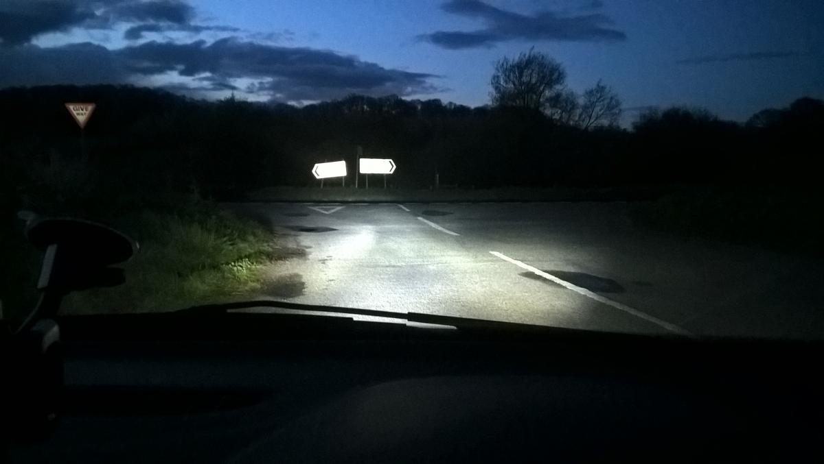

I thought I'd fit some LED bulbs in my headlamps - 2006 vRS Tdi.  They look great and light the road up much better than the previous bulbs, but trip the blown bulb warning on the dash.  Anyone know why this might be?
That will be because of the canbus system detecting a lower voltage than halogen bulbs. Think it needs an additional loom/resistor to sort the problem, as per fitting any LED bulb.
Where did you get them from, and are they H4 or H7? I got H4's from http://fourby.co.uk/epages/950004277.sf/en_GB/?ObjectPath=/Shops/950004277/Products/LEDH4 for mine, and yes, they are fantastic compared to standard halogens (even nightbreakers)
The yellow tint to the sides are the fog lamps for comparison
