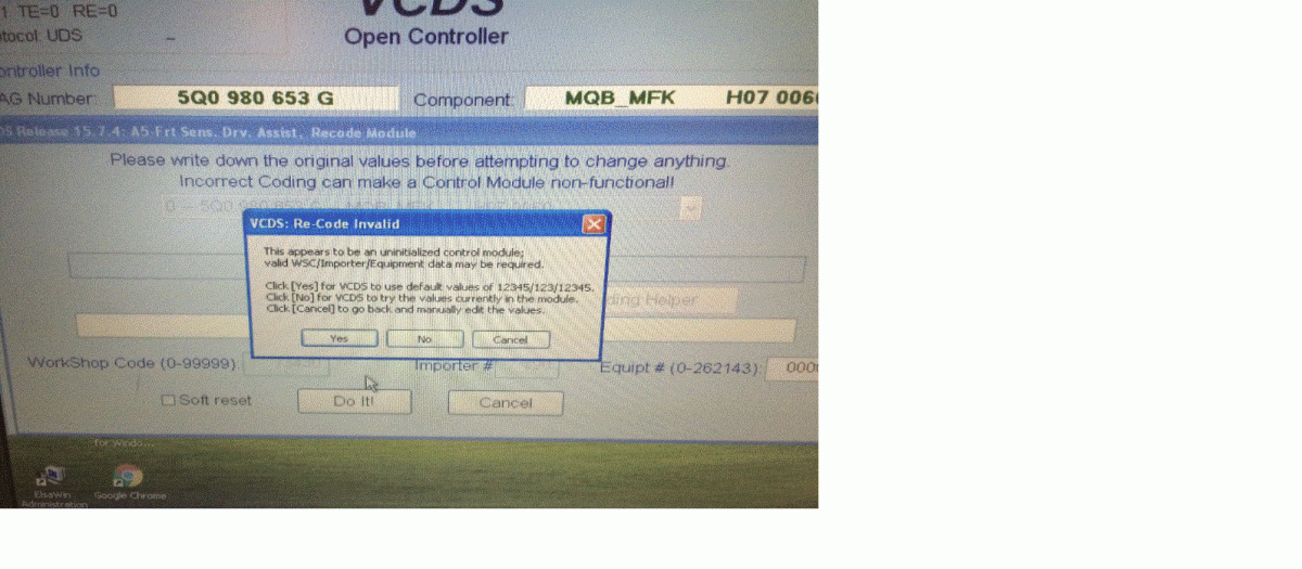

I have attempted to activate the Traffic Sign Recognition on my new Octavia vRS following the guides in previous threads. The problem i have encountered is in step 3:
Controller A5 (Front / front view camera)
07 - Coding
Byte 1
Bit 0 Enable - "01 traffic sign recognition (FTE) active"
When i have done this step i get the error message in the photo
Any help will be appreciated and just for your info i have limited knowledge as i am new to VCDS
Typical message on some modules at first coding attempt, just press Yes.
You can also check the VCDS manual for more details :)
+1
As above, nothing to worry about just go for it
Thanks all. I have successfully activated TSR and other things. A lot easier than I originally thought
