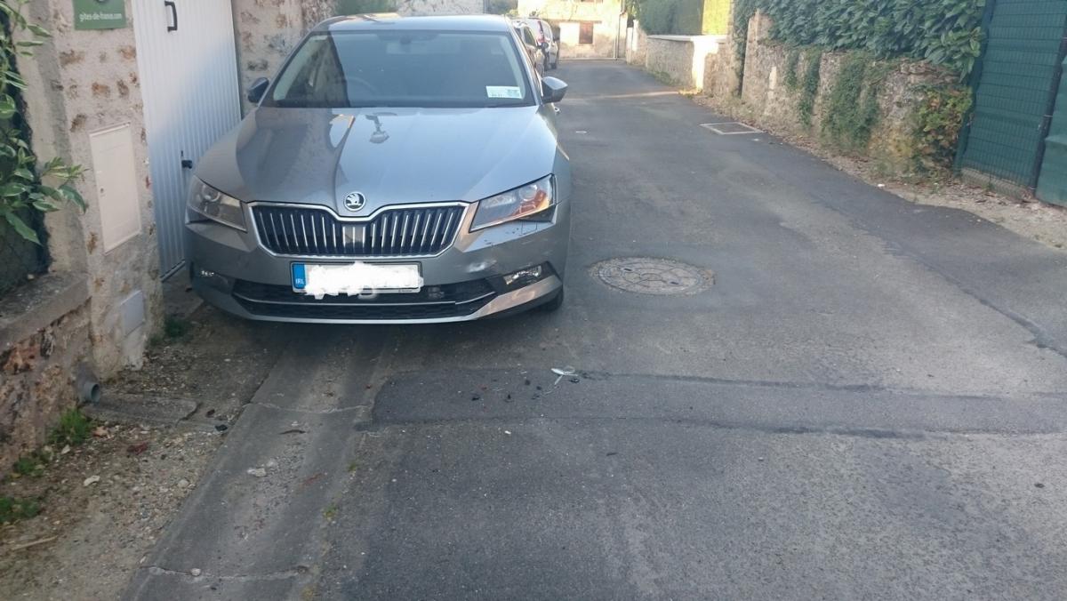

So, we rent a gite for a week, i have some reservations about on street parking but landlord assures us that its a very quiet street....  First few days are fine then last night there's a bang and I go out to find that someone has hit us head on (presumably drunk or chasing Pokemon as there's a 200M straight run to the car so its not as if it just appeared).
Guessing €600 to €1000 worth of damage as bumper dented and scraped and both headlight and foglight badly scraped.  i can't understand how someone could do this and not try to sort it out afterwards.  Same as stealing really.  Parts left at the scene identify the car as a 06/07 Renault Espace.  I'm watching local traffic and waiting  :devil:   Thankfully I'm older and more sensible now so dialogue and the law are the more sensible options.

Thanks - I'm not optimistic given that I've no identifying info...  There's a crack on the bottom of the bumper but I'm lucky that damage is restricted to the bumper and there's nothing on the side panels.  Looks like they stopped rather than swerved.
After a 10km drive there was a clunk when I engaged reverse but nothing since.  The car tracks straight and all lights work.  Thankfully the collision sensor wasn't damaged.
I tried to attach a pic earlier but it was too big.  Here's another attempt:

Even if the bumper doesn't look too heavily damaged, they flex a lot and stuff behind could have been damaged without you realising.
I'd be making a thorough check of stuff like headlight washers, radar sensor, parking sensors, bumper mounting points/brackets, whether headlights still swivel etc.
Ideally I'd want the bumper taken off to have a look behind it for hidden damage.

Thanks - that is sensible advice as the bang was quite loud and I expected to see more damage to mine.  The lights and DRLs seem to be working fine.  The lights aren't adaptive and I don't have front parking sensors but the lights their usual little dance when they are switched on. The radar seems to be working fine - luckily the impact was to one side of the bumper so the middle escaped.  I won't try the headlamp washers until I'm home as I'm afraid that they won't retract if they're damaged.  I am worried about damage to the bumper mounting points etc but its better to get it sorted than to have a bumper that won't quite fit.

Skoda dealer quoted €1500 to €2000 euro subject to stripping.  The car is safe to drive but a new bumper, headlamp, foglight lens, wheelarch liner, labour, paint etc all add up.  There was mention of recalibrating the radar unit but they didn't seem sure if it was necessary.
A panel beater who comes recommended and who does the bodywork for another Skoda dealer quoted me €450 to €500 to repair the existing bumper.  I need a new wheelarch liner as above (my existing one was breached) and I also need a new trim piece that goes into the bumper beside the foglight as the clips are broken on the existing one.  He wants to try polishing out the deep scratch in the headlamp lens but I may still need a new one at extra cost.  That quote is also subject to stripping but he was reasonably happy that he knew the extent of the damage. There was no mention from either party about the bumper bar so I'm very curious about the state of mine.
I'm planning to go for the cheaper option seeing as I'm paying for it myself.  I intend to keep the car for six years or so - that'll give me plenty of time to see if I can live with any aspect the repair that I'm not happy with and put some money aside for a more complete repair if necessary.
One thing that I'm curious about though.  I was driving last night for the first time in a while and found that there is a dark spot in the middle of the beam pattern (xenon lights), roughly covering two feet either side of the center white line.  Maybe it was there before the impact - I'm not sure - but I'm not entirely happy with it.  The beam pattern extends to the opposite side of the road and doesn't dazzle oncoming drivers but the dark spot in the middle is a bit mysterious.  Maybe its an issue caused by the deep scratch in the lens but its hard to say.  In any event, I reckon that it'd be safer to replace the scratched lens.

I would not be at all surprised if that deep scratch wouldn't cause a dark spot and even if he can polish it, that area would still give a distorted beam light.
If it was me, unless it's hellish expensive, I would replace the headlight.
I did see a post in the Superb II forum where the headlight bulbs not being perfectly seated led to a dark spot in the beams. Possibly the impact has shifted the headlight bulb. I'd check by alternatively covering each headlight to see whether the dark spot is on one or both beams. If it's on the damaged one only wetting the lens of the light might temporarily fill the scratch enough for you to see whether the dark spot goes away and confirm it is a result of the scratch.

I'd be inclined to agree that it'd be a false economy not to replace the headlight.  There's always the risk the polishing it might end up distorting the beam pattern enough to annoy other drivers
Cheers - that makes sense.  I've had a quick look around the headlight housing and nothing loose but I reckon that it'd be safer to replace the headlight unit in any event
