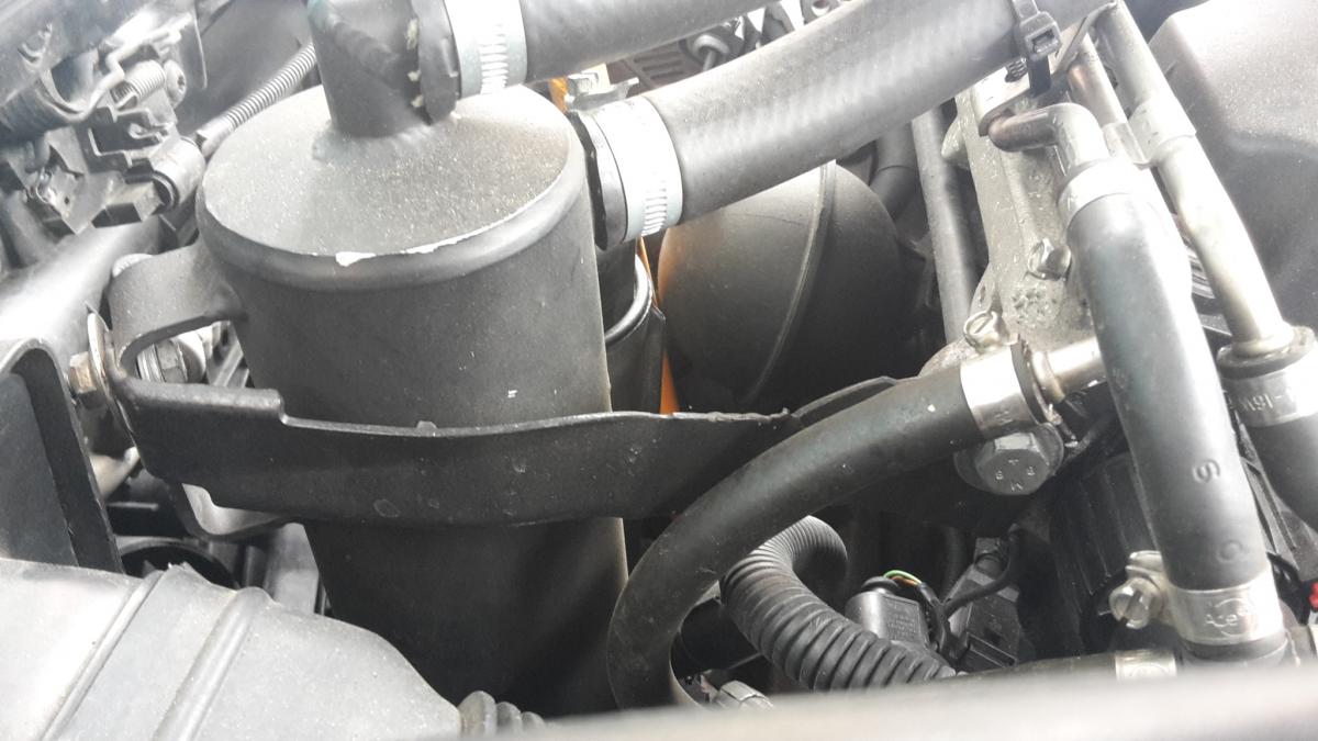

I don't, but it is the bracket that came with the Michi Catch Can.
I'll take a picture when I'm back on UK soil tomorrow if you still need it ....
I'm going to have a look at moving it tonight. The screw I used was the top torx screw on the bonnet latch with a home made bracket but I think it's made it a little too "bouncy" hence the rubbing.

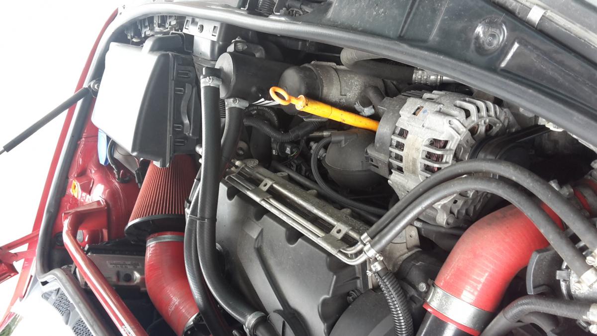

Remembered :D
Thanks for the pics, looks like I need to get some sheet metal...
