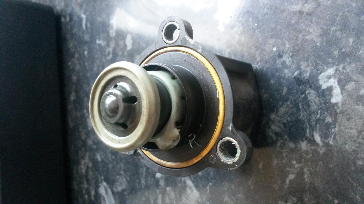

Well good news i sorted the problem it was a perforated diaphragm in the Diverted valve. Lights turned off on the dash and
wow does it go now. The cars decided its a rocket ship. picture below shows the problem.

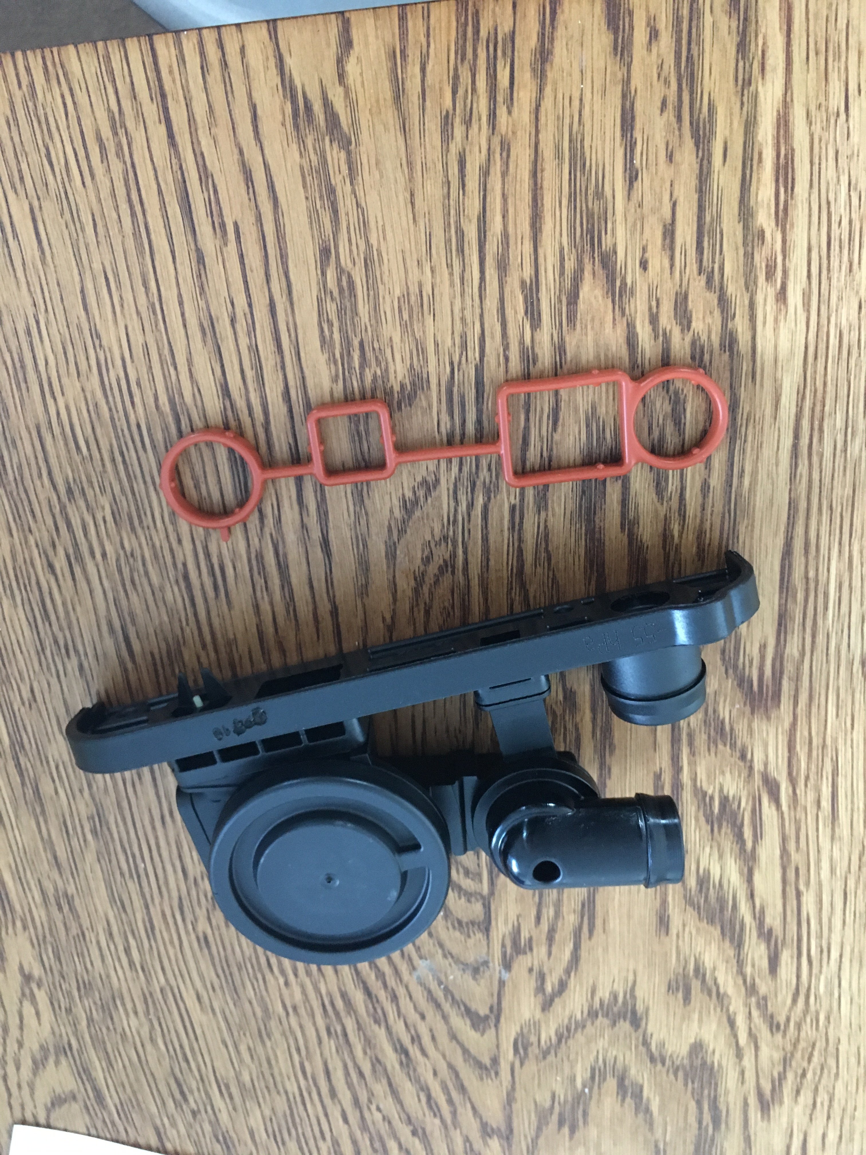

Also i have acquired quite a few faults in the scan so i would like to get them fixed anyway.
Been doing a bit more digging and it seams like the PCV Valve and breather pipes are the main culprit so i have
just ordered new genuine VAG replacements and will give it a go.
So PCV valve and new gasket arrived and i fitted this afternoon. The two breather pipes were in good condition no
signs of leaks or wear etc so i have reused them. Put everything back together cleared the DTC's with VCDS did
a rescan and exactly the same errors. Help please!!! what other things could it be? whats the next most likely culprit?
Edited by Scribbler
