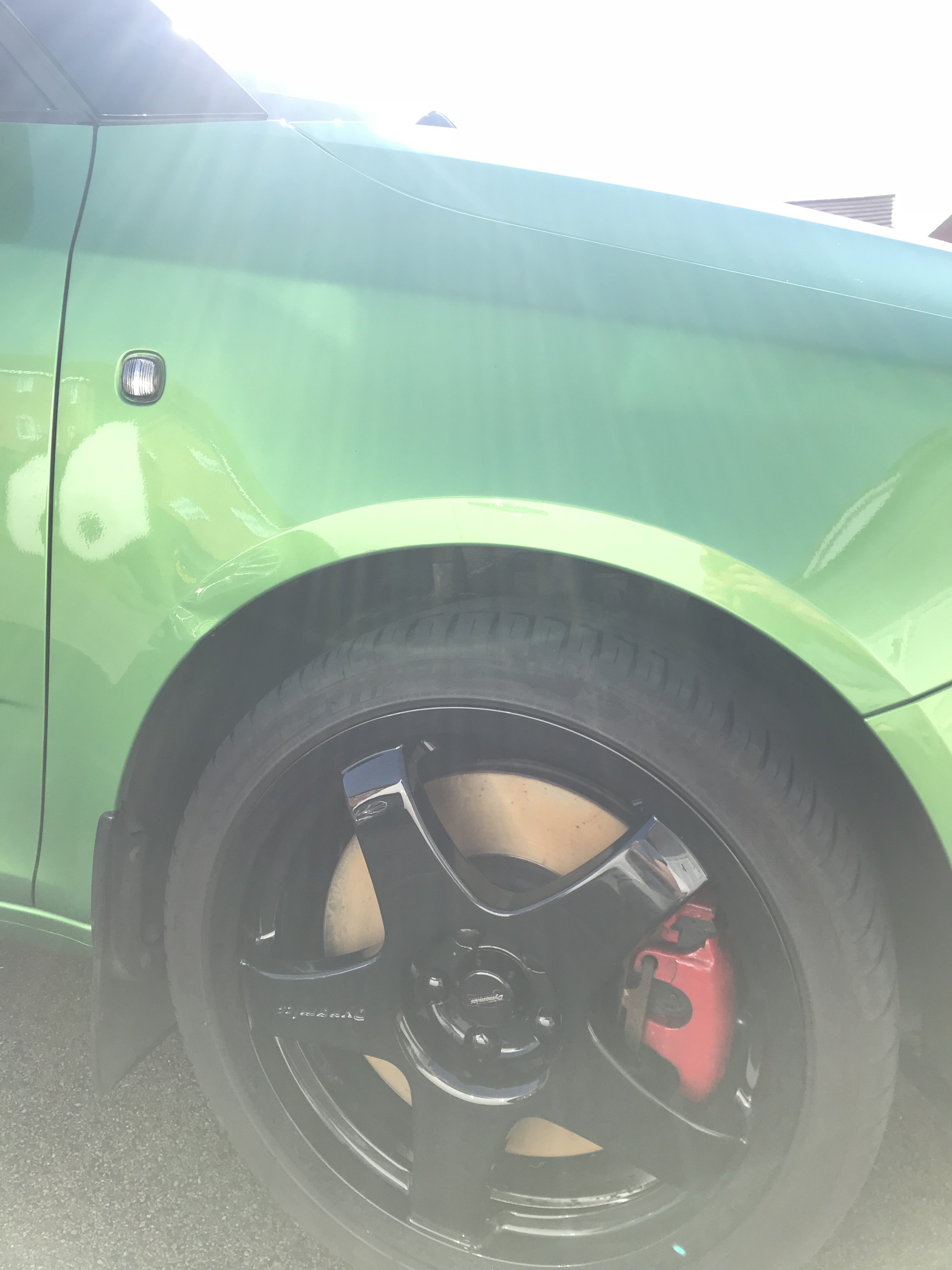

My standard vrs wheels would not fit without spacers, but I used brand new discs and pads.
The inside of the vrs wheel spokes sat against the callipers!  Fitted team dynamics pro race 3’s in the end as I don’t like using spacers.99A74B9D-4E7D-4DC6-904D-6DB98B86A53D.thumb.jpeg.573dcf36e1e6e7ad981df34388981782.jpeg

So sticking those brakes on with the stock vrs wheels isn't really viable. Is there any brakr upgrade you could suggest that wouldn't require spacers and without forking out a hideous amount? Thanks
The easiest upgrade is the 312mm- search the forums mate.  There’s loads of info on them :)
