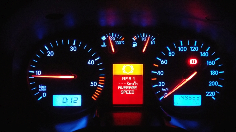

Finding an L&K black interior is like fing hens teeth. Your better off looking for a Mk4 Golf, Seat Leon, Audi A3 interior as they all fit. (Just so happens I amselling a full electric with homemade loom and full leather seats from a Seat Leon Cupra for £200 collected from South Wales). Costs will varie depending on condition, and seller, and can range from sub £100-£600. Chrome dash trims you can get on eBay for a Mk4 Golf. If you want the actual clocks you will need someone with relevant software to code them in for you as the immobiliser is built into the dash clocks.
These are my dash clocks in my Octavia wagon from an L&K. Also my Mk4 Golf leather seats.

Yes all mentioned vehicles are exactly the same floor pan as the Octavia Mk1 and seats are a direct fit, only thing if electrically operated you have to have the loon for power as for the heated seat elements they are a lot harder to fit as the looms are part of the interior loom of the car and unless you can find one and split off the heated seat section and get the relay and switch it's not worth the hassle. I do know of an L&K being broken but the seats are beige not black. The L&K dash pod fits straight in to the Elegance (that's the model I have). The chrome rings and centre chrome oblong are actually a set for a Mk4 Golf I just didn't use the ones that go around the fuel and temp gauges as the display is slightly different. The plastic section that's painted is actually out of an Elegance.

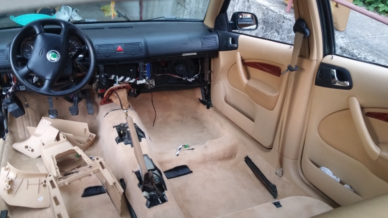

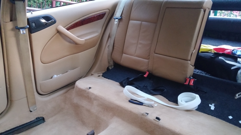

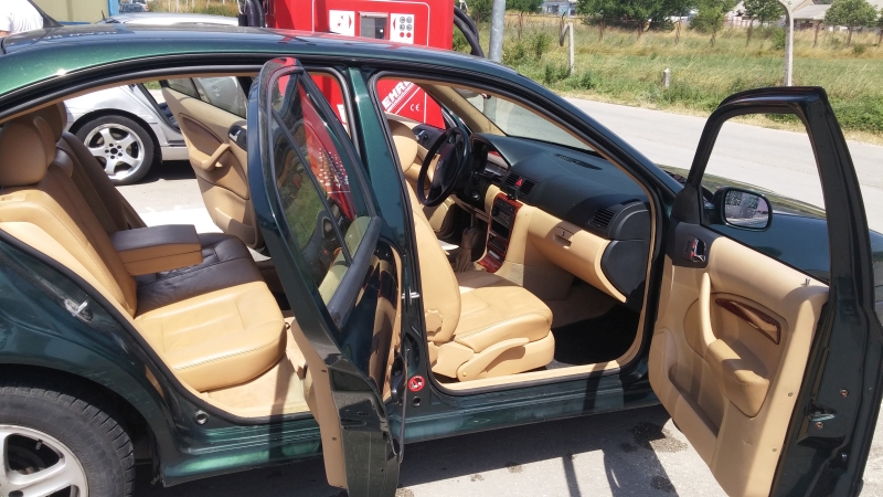

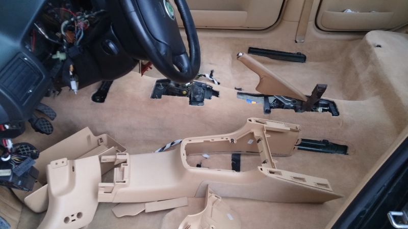

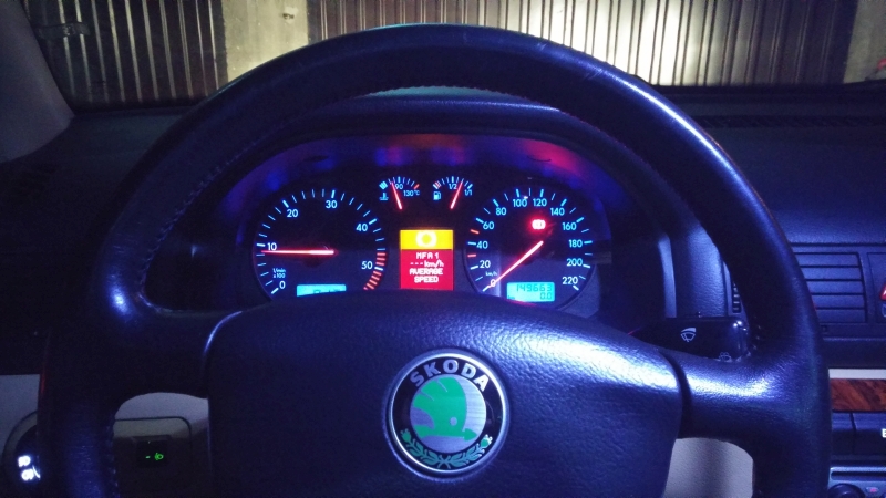

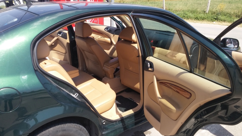

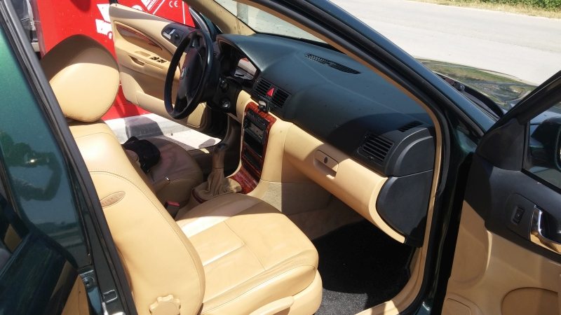

To give my little contribution... I have recently done same thing: Took my "elegance" interior and put in L&K one. Fortunately, I was lucky to find L&K interior in very good condition (and it was very cheap: 100€ for complete beige interior including door panels, carpet, seat belts and other beige upholstery parts). I also got leather steering wheel for 50€ extra. Old seats were not heated seats so I took complete installation from a donor car, and it was quite easy to fit as it is OEM. Regarding instrument cluster, I also replaced it with one from Golf 4, with huge display at the center. In reality you need about 6 to 10 hours of work and a lot of patience. I added few photos for you to see how it went.
Good luck in your work

Looks well worth the effort Arminator.Very smart ,wouldn't want to use it! Hope mine looks as good when finished.
