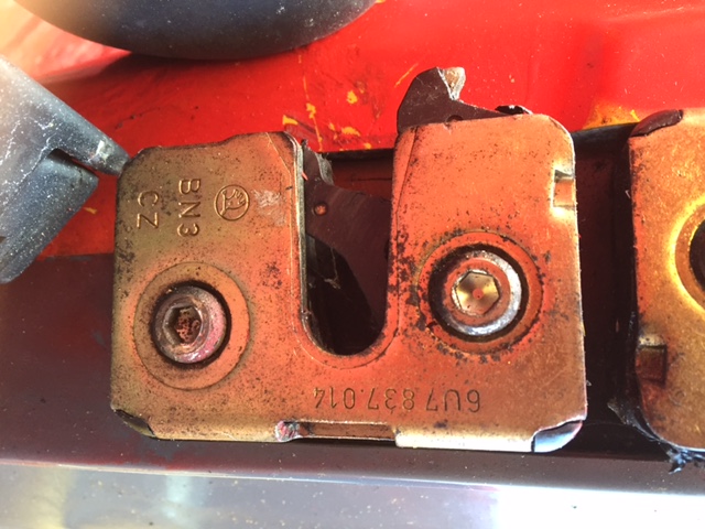

This is my latch, not sure if it's faulty. The door won't stay in the open position for some reason

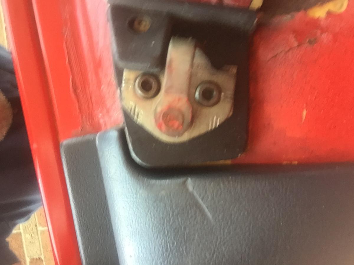

Looking at it today it looks as if it isn't sitting back far enough, if I undo these 2 bolts will I be able to move the pin a little forward?

Disassemble the latch, clean it, assess wear & tear. If nothing is broken or bent or too worn, clean parts with petrol, cut any plastic wrap that might rub, grease, assemble, check parts are moving smoothly.
The bolts are exactly for that. Positioning.
They seem really tight, I might have to drill them out, is there a nut on the other side or a plate with threaded holes? Thanks
Your last photo is not focused. After I've enhanced it, it seems that the head of the screws is destroyed. I think they are Philips screws, maybe countersunk multi-point socket head bolts.
