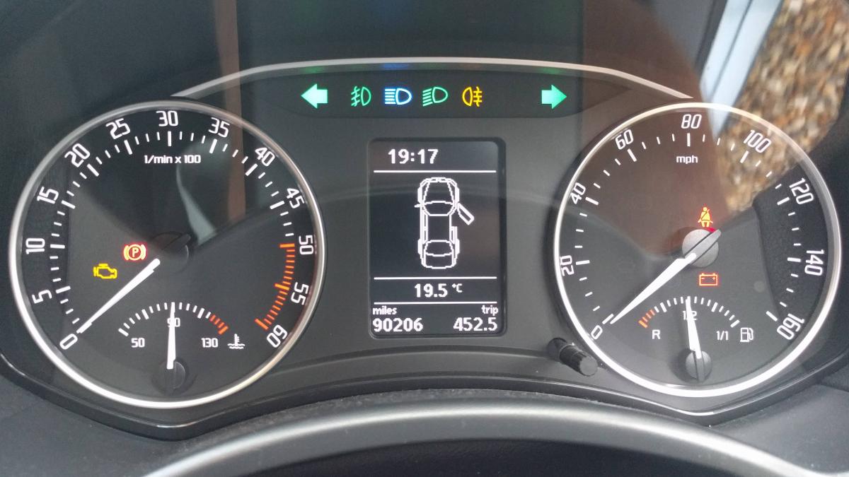

The green symbol between the blue main beam and yellow rear fog lights warning is for dipped or low beam headlight,  not front fog.  As said the symbol for front fogs lights up in the switch itself.
On the FL it's part of the instrument cluster :)
Along the top it is:
- left indicator
- front fog
- main beam
- dipped beam
- rear fog
- cruise control
- right indicator
I think on the pre-FL, the front fog symbol is on the switch.

Just took a quick picture for you Mike, cruise is in the gap between rear fogs and right indicator :)
Mine is yet different; the parking brake indicator doesn't have a P inside, and sits in the right dial next to the battery indicator.
Langers2k: did you take that picture during the lights show after switching on the contact? I just checked: I no longer get that show, except for the red error indicators. I get that for the indicators that depend on the failed switchgear, but I don't see why the others don't light briefly. Or, I'm confused with my Guzzi, which lights all indicators briefly (and lets the dials go all the way) when I turn her on.
Mike: no, I wasn't even aware that those fog light symbols were indicators. In the beginning they confused me, and it took me a while to figure out how to light the fog lights other than by turning the switch towards those symbols.

So the indicators on the top row don't come on briefly when you switch on the car? Good for me (except for the part where I don't know what made me think that :) )
(And of course I knew why the picture was taken, I was just mistaken how it was obtained.)
