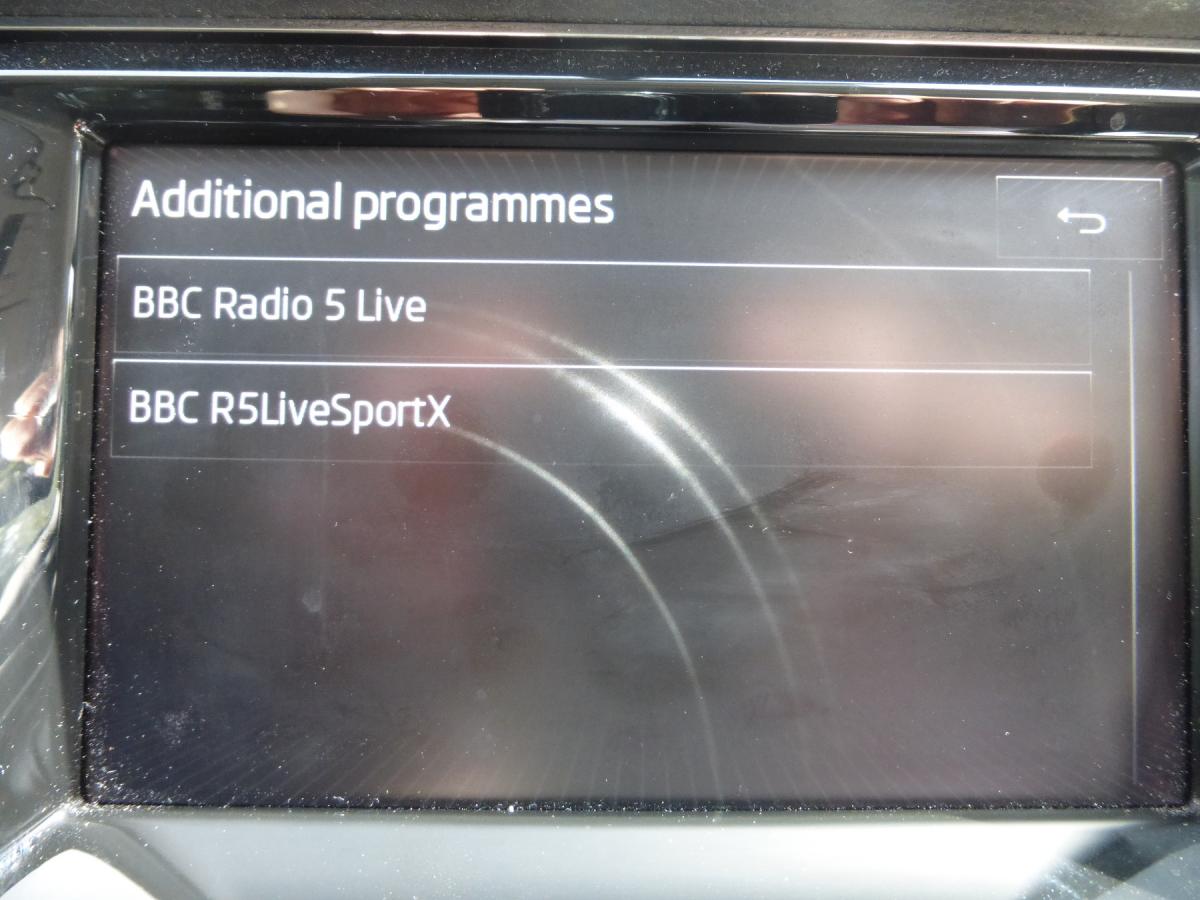

I have a couple of additional pictures, showing the arrow off to the right of radio 5 live in the station listing,
and the last one shows the two "additional programmes" BBC radio 5 live, and BBCR5SportX, which I will try and upload below.

It's difficult to explain but I do not get the exact same display as you have shown. On the stations list as you show, 5 Live has a green arrow and I have to touch the arrow to get a drop down which is 5 live sports x.I can only get 5LSX by touching the green arrow, but when I try to put this on a pre-select button, the button shows  5 Live, not 5LSX. You show the button going to 5LSX. I think this might be the reason why 5LSX is lost when the ignition is turned off. I live in Newcastle upon Tyne. Maybe the transmitters are different across the country.
It is true that 5LSX is only broadcast at certain times. In Newcastle, it carries Test Match Special which I listen to and this is when I get the problem. I think that probably this is the only time the radio loses connection on restarting the car.

As I understand it, 5LSX is on a BBC National DAB multiplex/ensemble - so it should be the same in Newcastle and Birmingham.
I've just tried again, starting from scratch: all DAB presets cleared, and DAB rescan.
5LSX is still second from the top of the BBC National DAB list, and when selected from that position on the list it will store on a preset.
