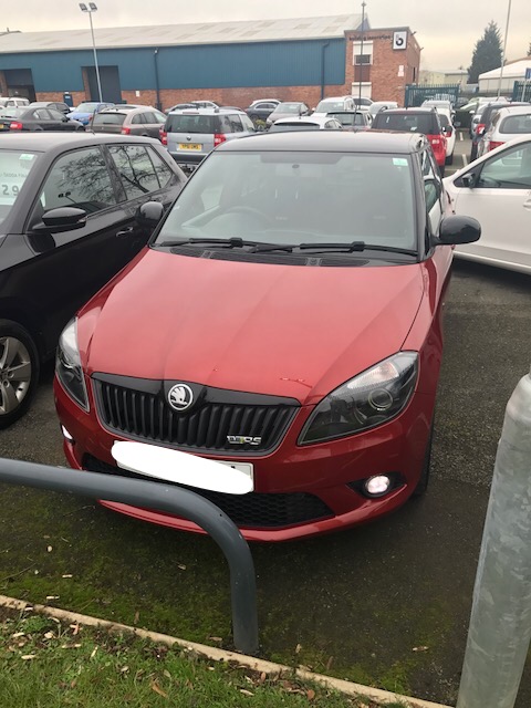

On the VRS I purchased the DRLs are on in the photo - looks like a 4 bulb LED light in each side and in my 2014 Fabia brochure here it states the vRS has LED DRLs which are located where the fog lights normally are in the front. Am I getting my wires crossed here?
You are showing the DRL's and on your car there is likely no 'Off Switch' beside the fuses being a newer car.
Those are also the Sidelights when you switch on the sidelights, (or Sidelight & headlights.) they are just less bright when sidelights.
Ok thanks.
