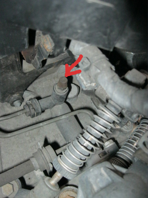

Is this the clutch bleed nipple?
Hi,
Is this the clutch bleed nipple for a 2010 1.2 HTP.
Photo taken from top of gear box just underneath air filter box
Thanks.
Edited by 247
Sure is.
Thanks Tech1e
Yeah. Don't try and bleed it "properly"
Pipe into a jamjar with some fluid in.
Pump the pedal a few times, hold it down.
Open the nipple, pump it a few more times slowly.
Close the nipple and top up the fluid.
