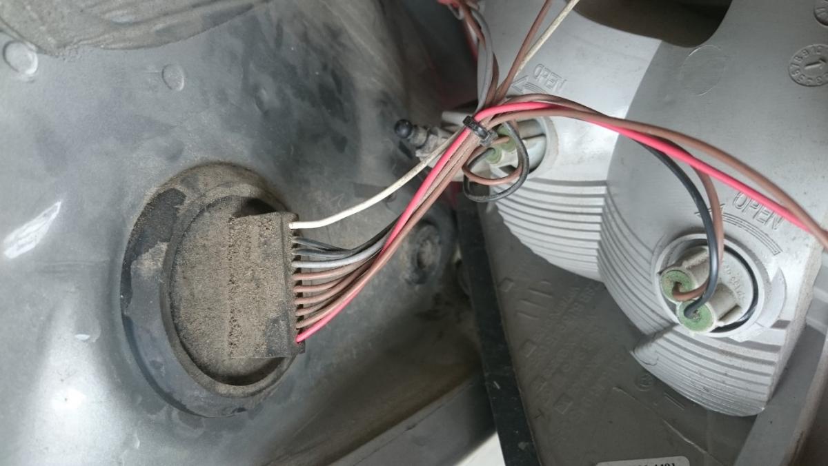

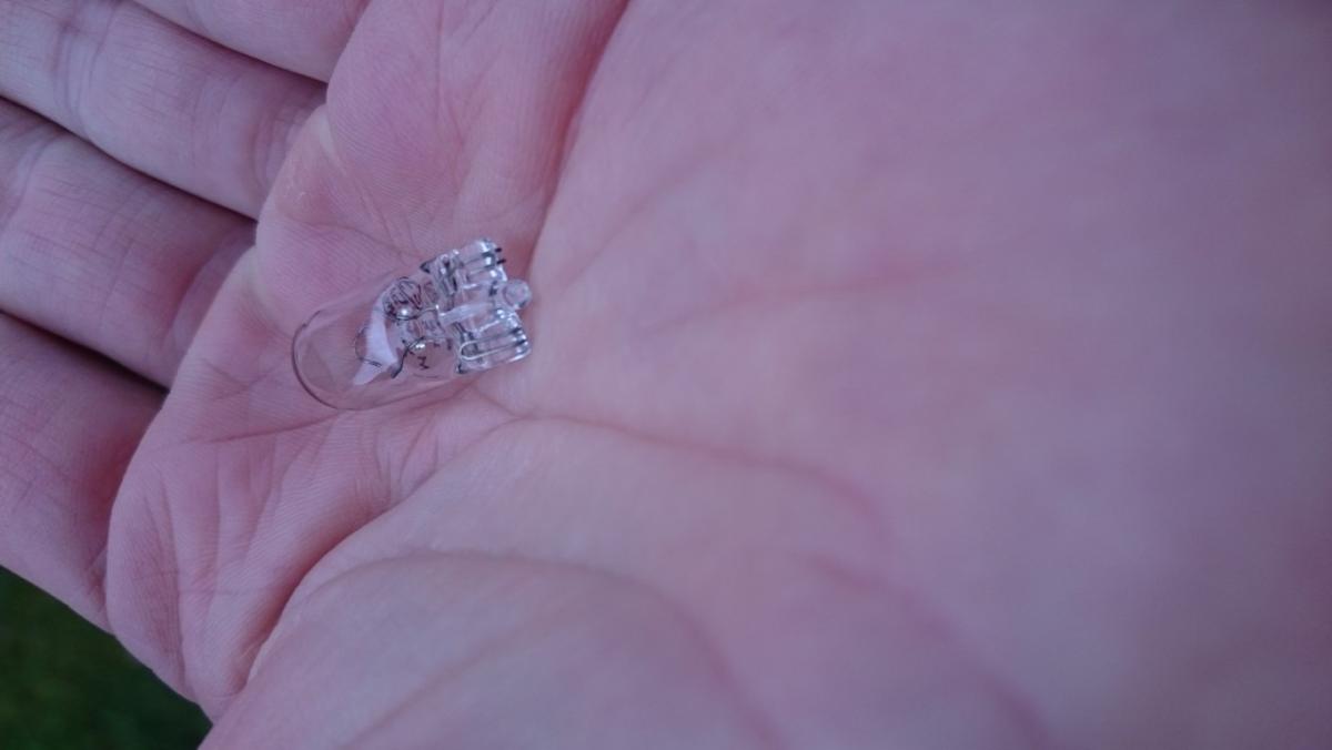

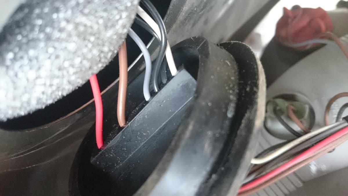

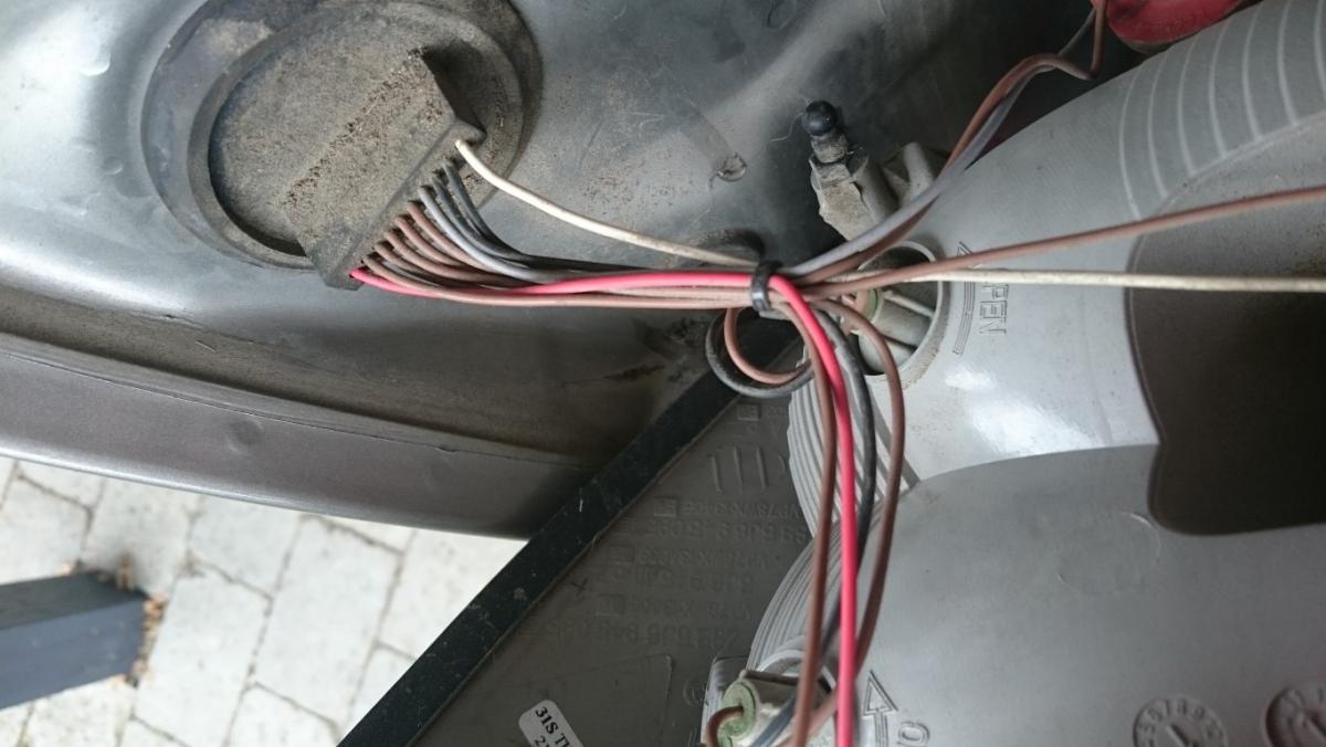

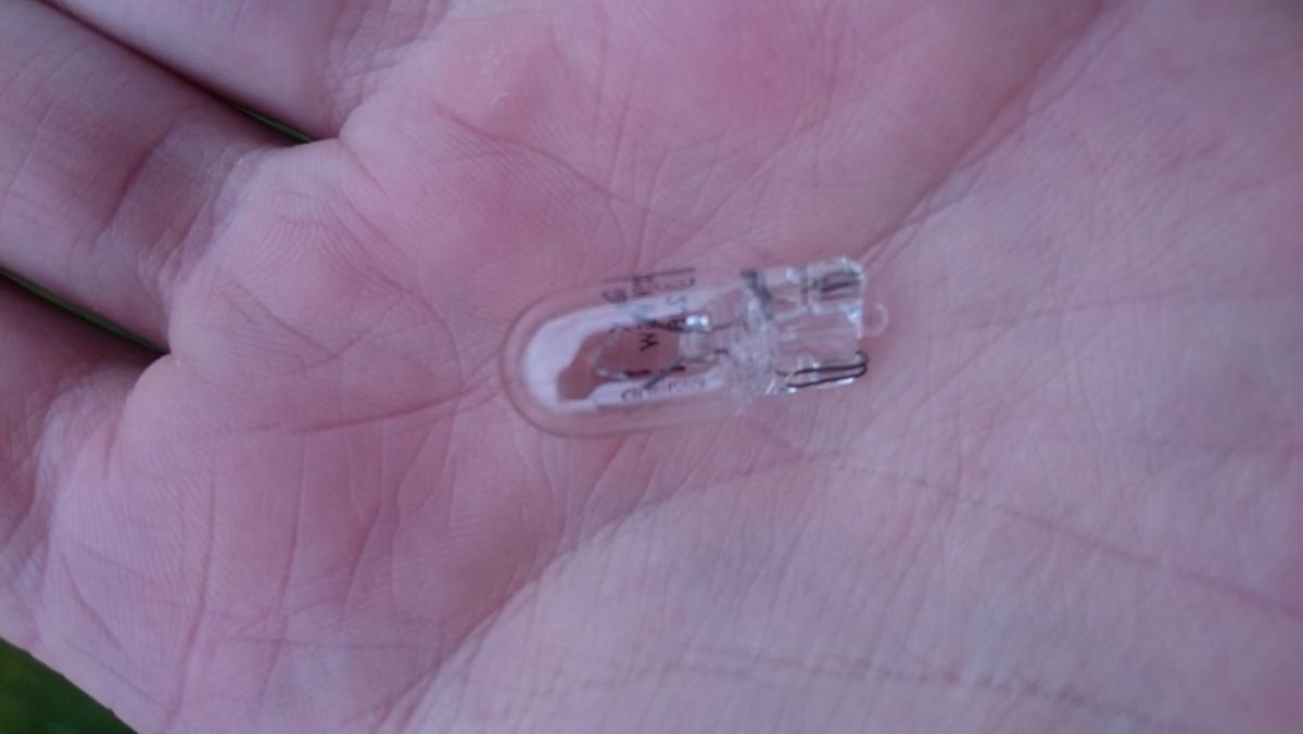

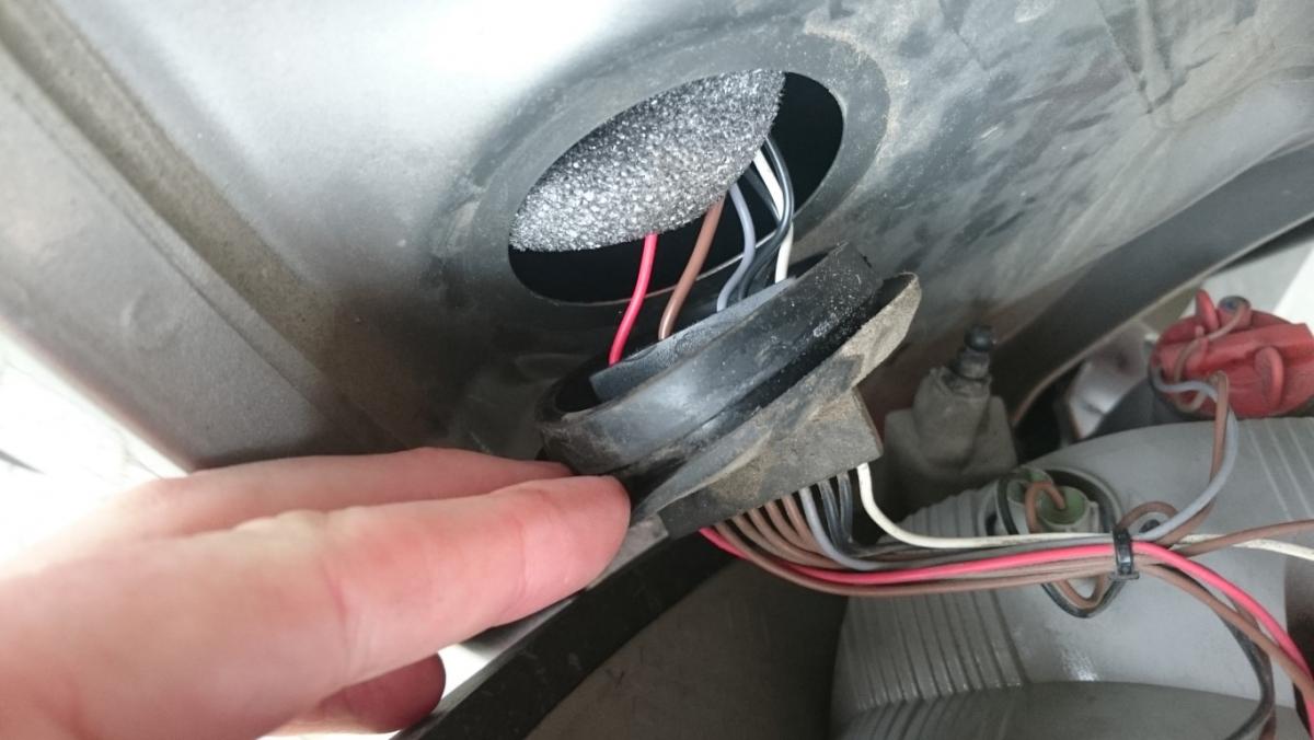

I have tried to take some photos.
It seems to me all wires and bulbs and contacts seem fine.
The problem did not occurwhen I took the pictures - but after assembling the light again - I started the car and the bottom bulb were out - I took a video of it.
You can see the pictures in this post.
I also uploaded a video of my tapping :)
https://www.dropbox.com/s/s6qewc2ki1ihxho/MOV_0625.mp4?dl=0
Looks like the connection of the bulbs in the holder that is the issue even though you have ruled that out.

I changed both bulbs and the problem went away. Strange but solved :)
Ive had this issues with another car before.. golf mk4 i think. what happens is the bulbs blow and when you tap it the filament makes a connection and the current re-attaches the filament temporarily.
that was my findings anyway :D
DamoR, once at work, when there was suddenly a supply issue with some strange model of bulbs, we did resort to turning the "blown" bulb round then tapping it with the DC supply ON, so that teh filiament re-attached for "a while" - to buy time!
