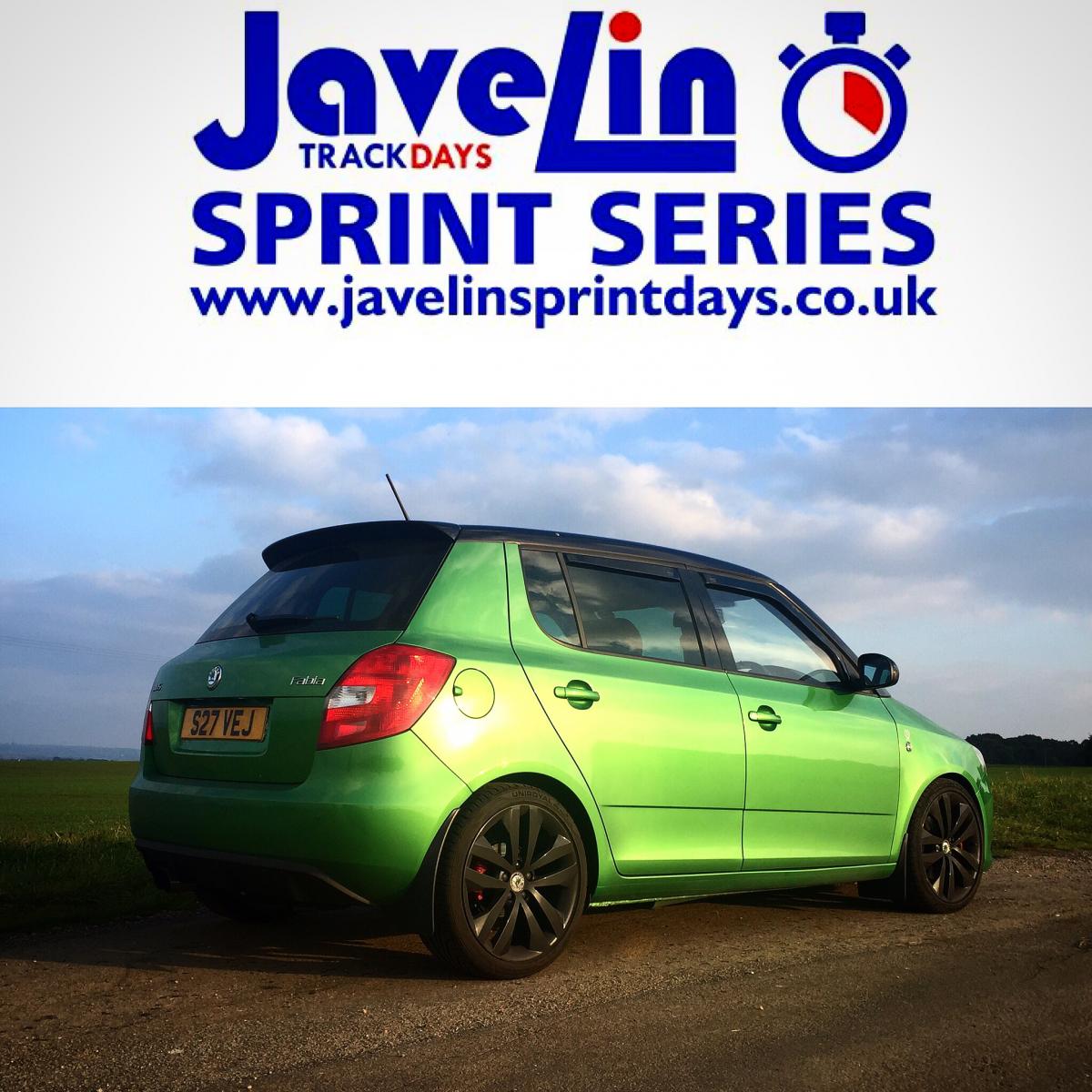

Can't wait for the dates and classes to be announced for the Javelin Track Day Sprint Series I will be competing in.
The last round has just gone at Snetterton so just awaiting the classes and dates as they have had unprecedented entries so they are streamlining everything.
Bring it on!!
