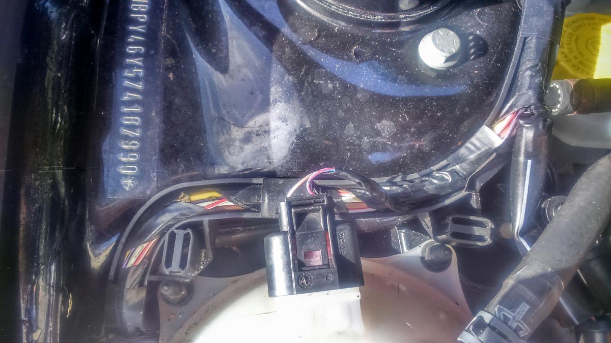

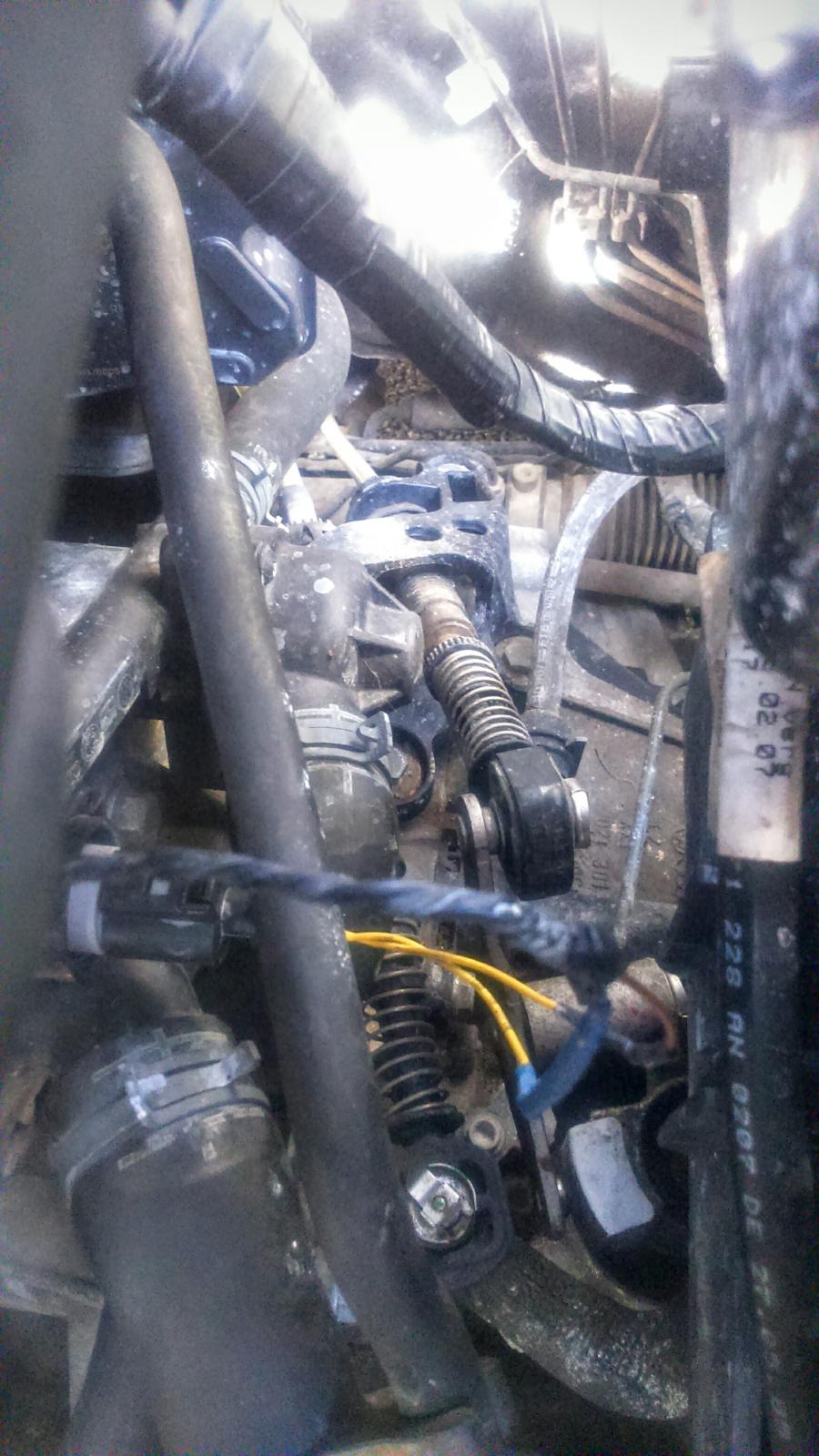

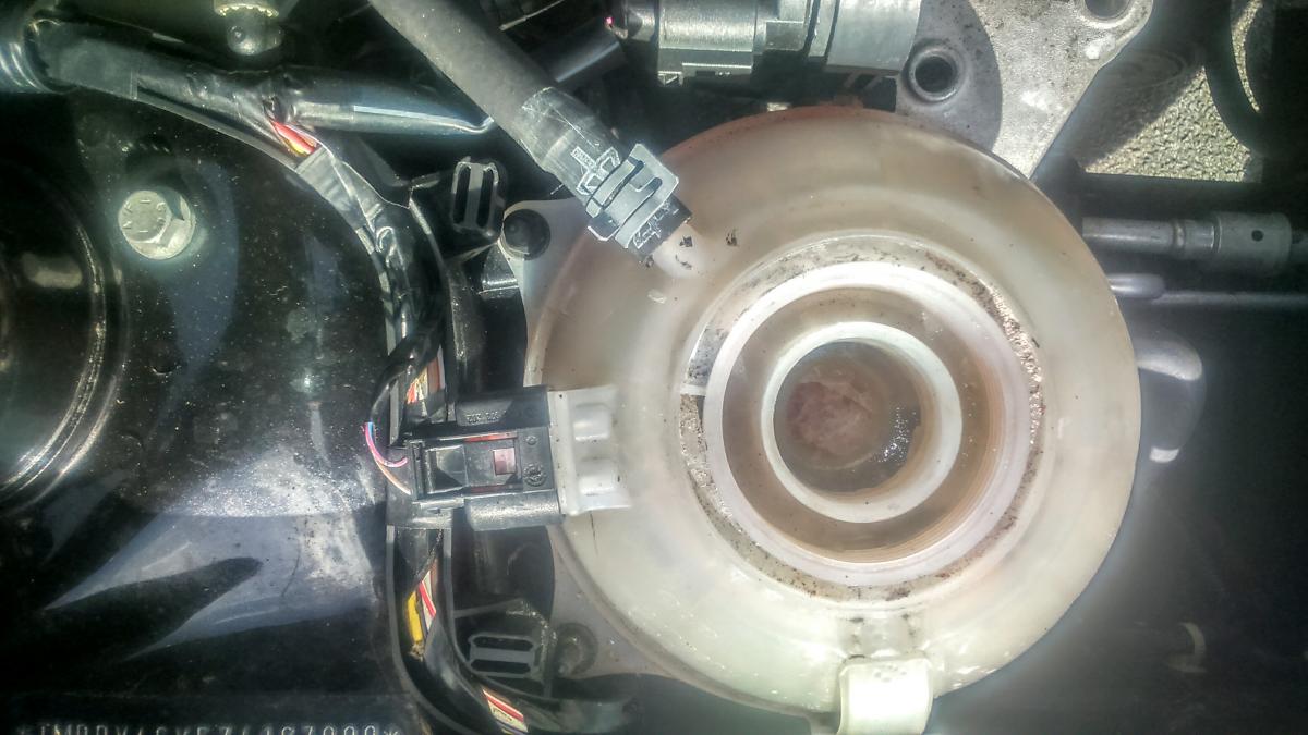

Can't see any metal sensor prongs in the expansion tank. The garage mentioned that it looked as if the wiring had been played around with; having looked more closely I can see what they mean. I'm sure Skoda don't normally wrap insulating tape around cable runs. post-148309-0-77894500-1474739219_thumb.jpgpost-148309-0-47131200-1474739232_thumb.jpgpost-148309-0-08558000-1474739271_thumb.jpg
Yep the terminals in that plug have been replaced as some point.
So have I been looking for the wrong thing? I assumed the sensor prongs were further inside the tank. Guess you're talking about the plug attaching to the top of it (L/H side of photo). I can't get to whatever's inside the tank as it seems to be sealed.

I think Ken was talking about the prongs of the sensor itself, but as you've discovered, they're utterly inaccessible (without a hacksaw) on the Fabia tank.
I'm talking about the coolant temp sensor which given your issue is the more likely candidate than the level sensor.
