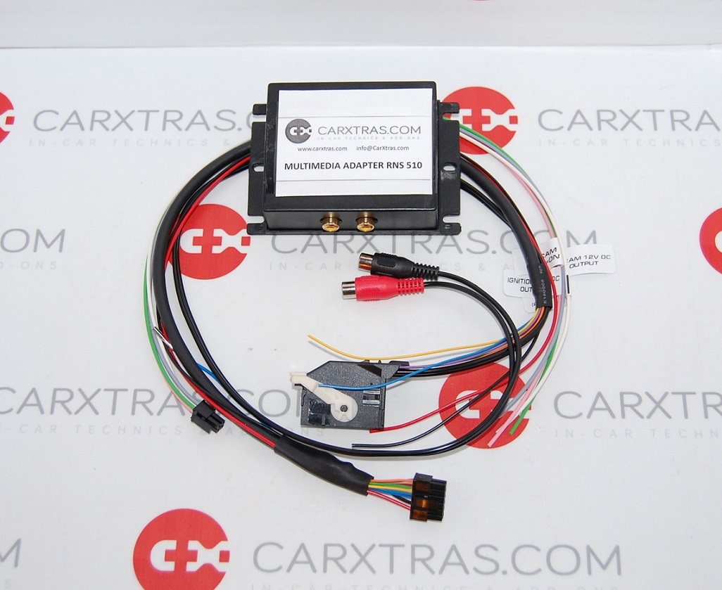

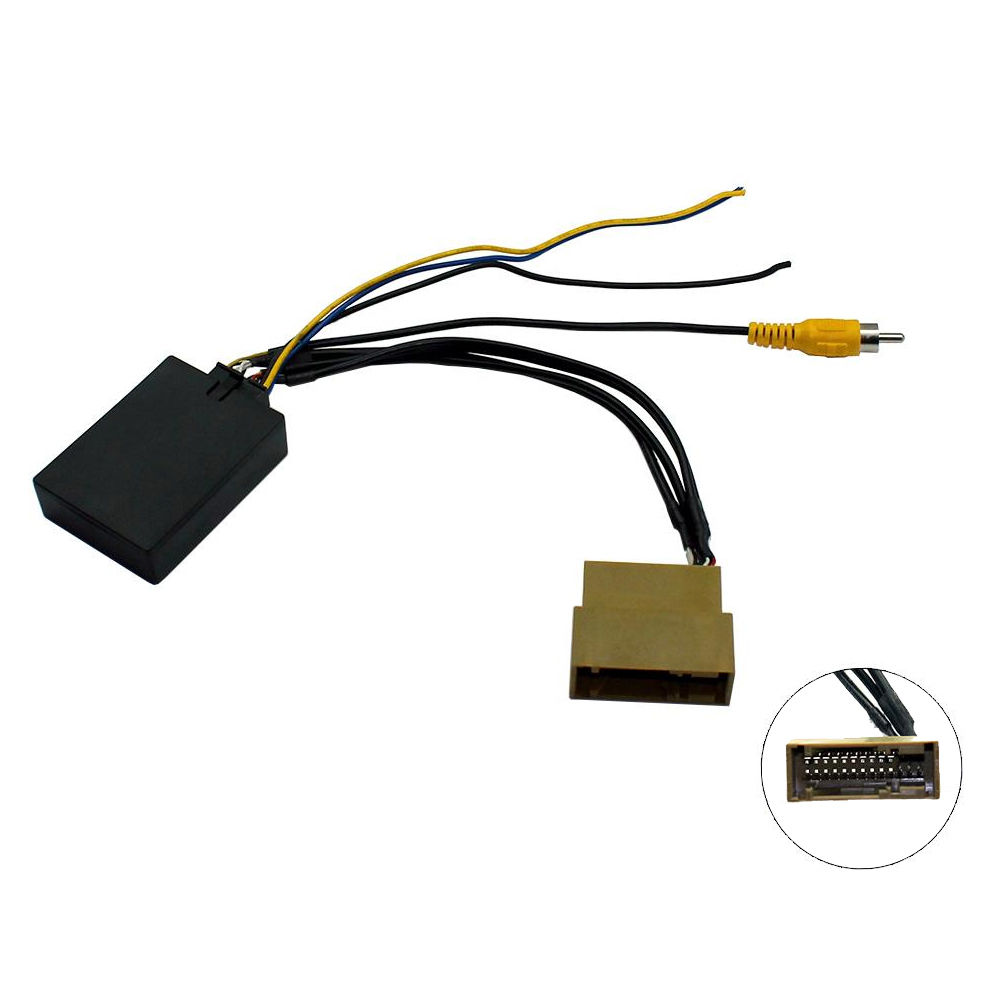

i used this with no issues
http://www.ebay.co.uk/itm/231902600220.
which was a lot cheaper than using kufatec direct strangely.
Edited by tubbytommy
That's the exact same interface that both myself (in 2 cars) and the Profesor above have used. I was lucky on the 2nd car as I found one on ebay used for £65/. Works a treat though.
Having seen a few camera installations, I'm leaning more and more to the way of always doing it by a proven route. It may not be the cheapest, but quality and reliability always come at a price - and my two setups have never once given any cause for concern.
Mike
Couldn't agree more,i bought it as I knew it would work as it was proven to work by other members including yourself.

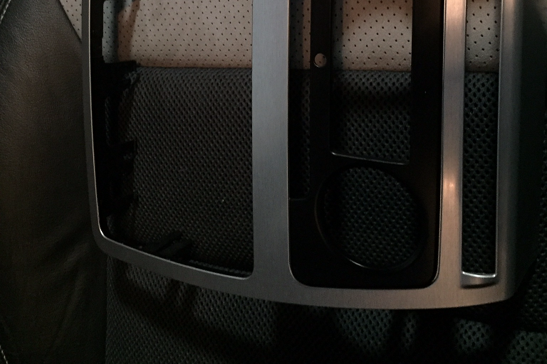

For a Columbus and standard VRS interior (brushed aluminium look), then this is it:
http://www.skodaparts.com/product/octavia-trim-for-navigation-system-2009-2013-50216
I sent a link to that site to my local authorised service department who ordered it through the official channels, and it was £58.07inc just under a year ago. I got it the next day from them. This is for a FL.

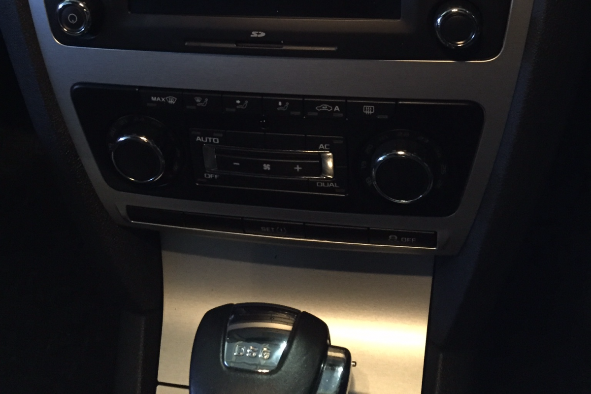

this is what i have at the mo
That looks like the same trim as mine (2011 FL VRS), so the one in the link certianly looks  like what you are after. Double check the finish here: http://www.cars-equipment.com/www/en/shop/navigations/oem-1z0858069dkdf1-navigation-aluminium-trim-for/#prettyPhoto
Notice that the new one for NAV has additional material around the unit hole to make it squarer. The Bolero (I assume that is still fitted in your first picture) is slightly larger and more of a rhombus shape so fills those bits itself.
When I ordered mine the parts manager had a bit of a moment and originally didn't recognise the full code with the letters at the end as listed in the link. Beware that the number is used for both pre-FL and FL setups, with the only differences being the letters that designate the finish type. Make sure you

Dose the black peace in the middle of the climate control come out as in my rubbish picture the climate control is sort of oblong,
