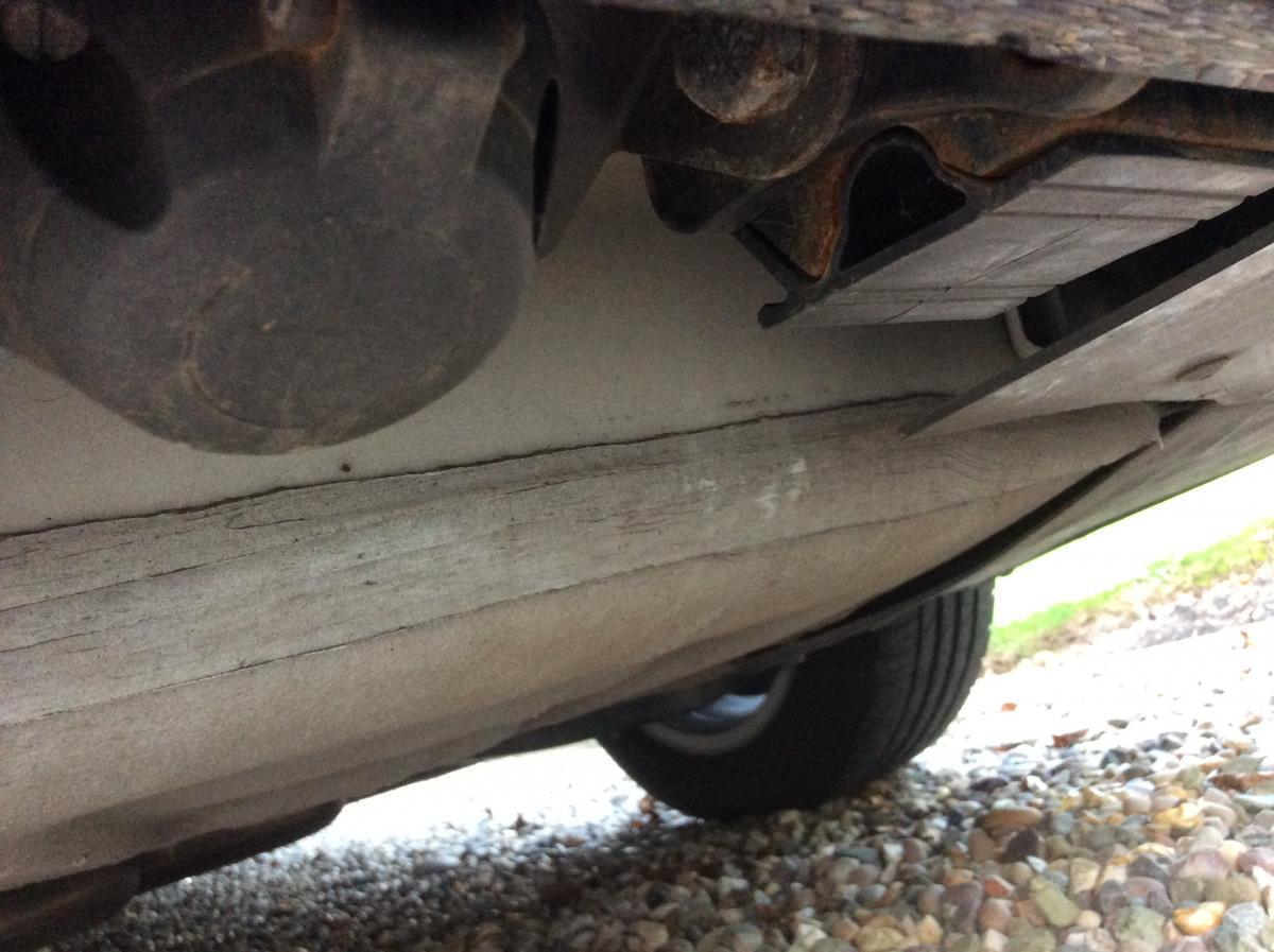

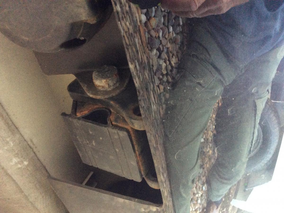

Mine, a Witter detachable, looks like this.
thanks for the replies. Looks like I can just cut it out.
