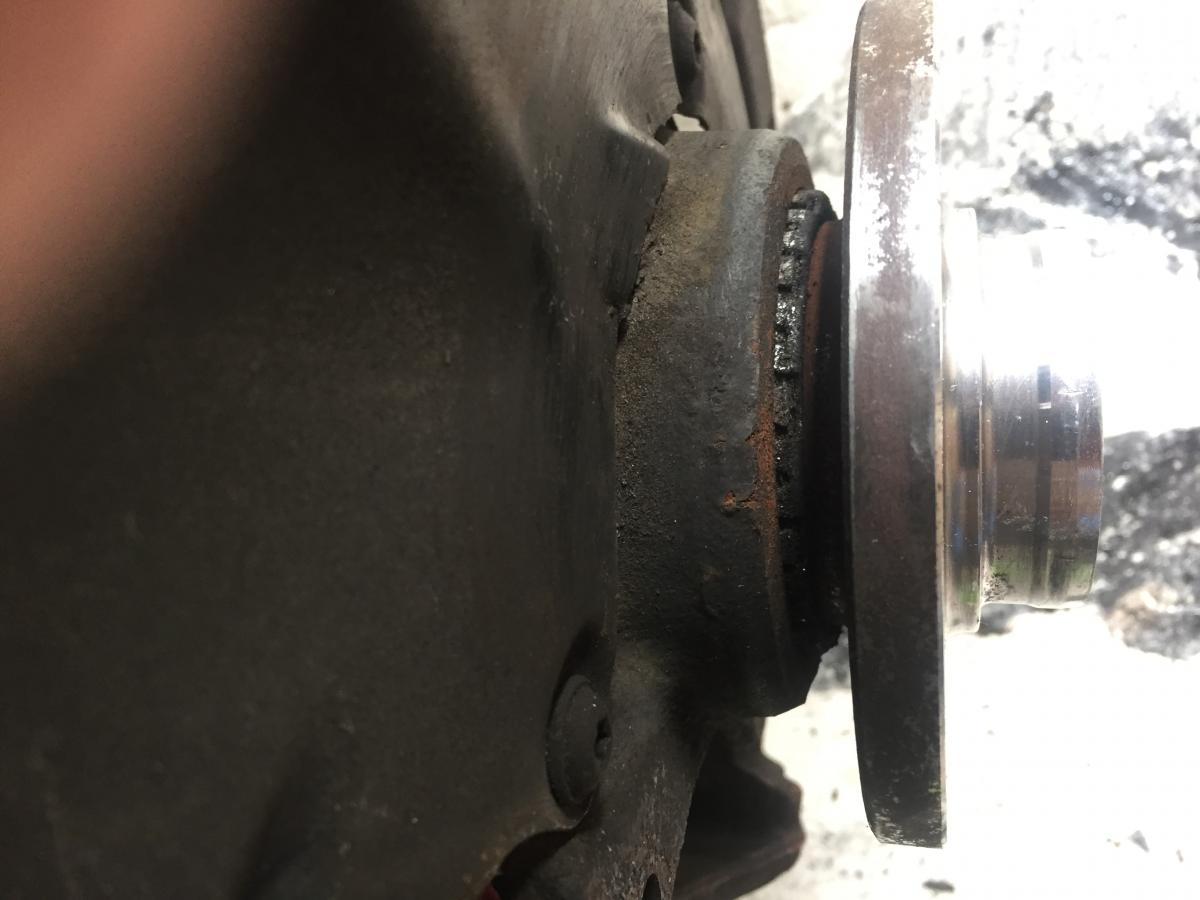

This is what it looked like before having it repressed which looks to me like a result of not pressing it correctly as you've said.

It isn't like that with this type, have a look at the pic I posted and the video.  No circlip.

Cheap copies of the tooling can now be found, but durability is probably rather low. That may not matter for the DIY'er. I used such tooling to extract that bearing/hub in my photo above, but it took a looong breaker bar to start the thing moving, with stripped bearing carrier in a sturdy vice on a heavy workbench. May be easier on a newer model admittedly. Haven't tried using it for fitting yet, the removal was just a practice run on a spare bearing-housing, 2003 era.
